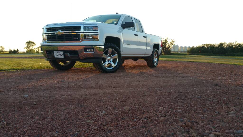

2" zone level 33x12.5x20 Toyo MT's
How in the world did you fit a 33x12.50 with 2 inch level?! I don't even think I can fit a 33x12.50x18 with my 2" Motofab level.
Looks amazing!
Looks amazing!
The rim size doesn't matter on a flotation sized tire.
A 33x12.50 is actually more like a 32.5x11.5, so it's basically a 285/65/R18 or 305/60R18....both of which fit with a level. It's "usually" easier to fit a Mud Terrain than an All Terrain in the same size because the M/Ts run narrower in tread width.

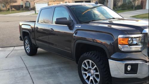

It's not that bad..... Just a tiny but of rubbing.
