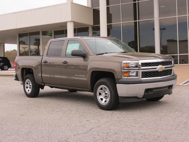

Just purchased a 2015 silverado LS. Same as photo except I have mud gaurds.
I plan on running a 1.5" front motofab level. With this set up can I run 275/60/20 ko2s?
My buddy has a sierra with 2" front level and running 275/65/20 with no rub.
Just thought I'd check before I purchase?
I think you should be fine. My girls truck is leveled 2" with that tire and size and she has no rub but 1.5" im not sure.
