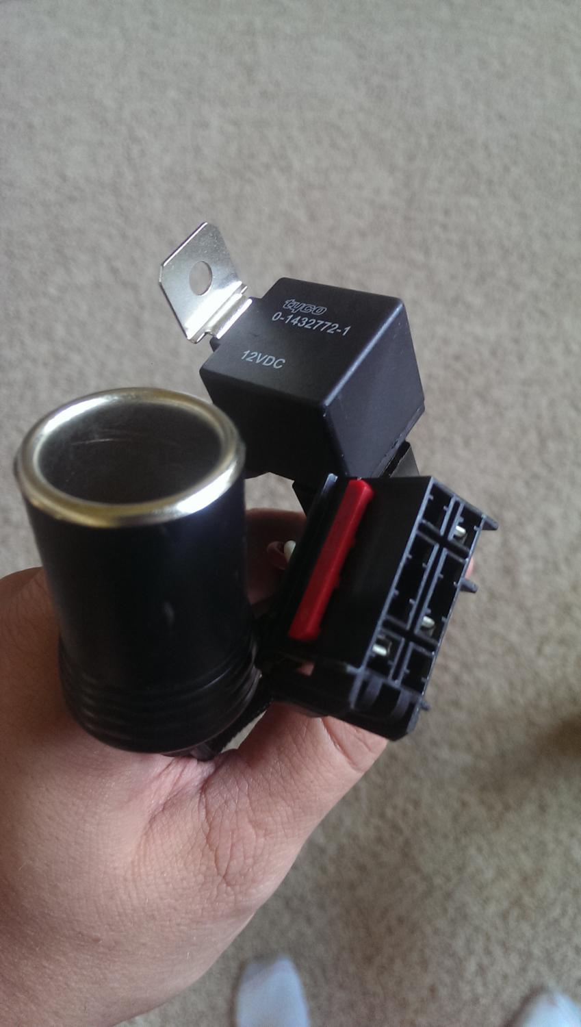

I have a question although maybe I should start a new thread but this seems to apply. I bought a 12v female plug that tapped the RAP port on my 07-13 truck. I has an inline relay and worked awesome for my GPS. I'd like to switch this over to my 14 Sierra. The photo MotoMedic posted of the plug on the floor seems to have 20 pins. The adapter I have only has 8. Does anybody know the bare plug part number for the 14? I'd like to get ahold of it and switch it out on my adapter accord to the pinout posted. Posting a photo of what I have. Sorry, I tried to read through but didn't notice anyone posting the part number for the female plastic connector to fit the 14' RAP. I know I broke the no toes rule, it was a hasty pic (just be glad I'm wearing socks!)
