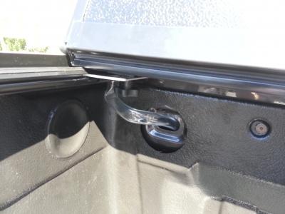

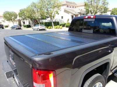

I just installed my BakFlip FiberMax on a "standard-box" (6.5') bed. Two pics show the left/right drain tubes, one pic is the look of the FiberMax closed. I have concern the drain tubes are 'crimped' trying to navigate that tough angle from the rail to the drain holes, so I may have to doctor this arrangement up. I will re-post when I have actual weather experience with this set-up. Living in S. Calif we are not in any rain season yet. Also, there could be "blow back" from the holes where the tubes go outside the box, but guessing that will be minimal. If not, I will have to find a way to seal up the rest of the plug area exiting the box (maybe by drilling a hole in the bed-plug that matches the size of the drain tube).
(Note: the pic shows I am going through my "drop-in" bed liner (with porthole access to the original bed plugs) - it is removal of the actual bed plug that gives you access to draining outside the box.)
Hope it helps. I'll look back here too for other experiences with their setups too.
icetime - I put my drain tubes in the same place, but they aren't squished down like yours. I cut them to be just a bit longer than the distance needed, and they seem to work fine so far.
thanks roadblock - duly noted. good to know that this setup should work. Do you have actual wet weather experience on the draining yet? I actually have no idea how much water gets into the rails drain path (i.e. sizable or not).

Do you guys mind posting a few pics of what your covers look like installed?
