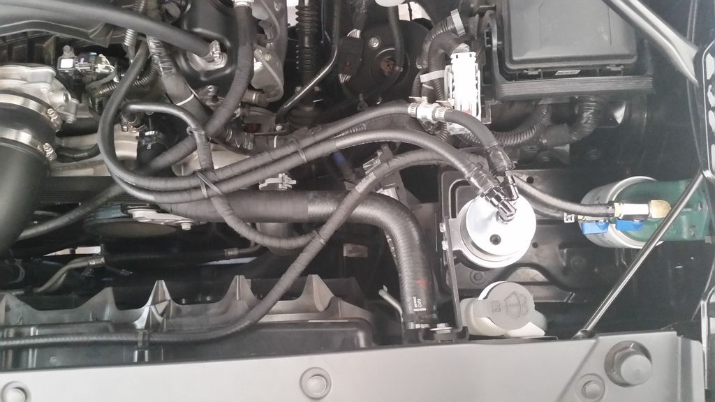

Got my catch can in yesterday. Not a single direction in the box. I told them I wanted to mount it in the spare battery location. So since there's no directions, where does it actually mount? To the bottom of the battery tray? To the battery tie down support?

I think I used the bolt holding the windshield washer bottle to attach mine.

Well the only place that made since with the bracket they supplied was to bolt it down to the bottom of the battery tray. I'll get pics shortly. Hopefully I did it right.

Here's how it's mounted. Has anyone else mounted it like this? It's bolted down to the bottom of the spare battery tray.

Here's another mounted in that area. The way you have it doesn't leave much room for drainage.

Flip the bracket around to attach to the washer bottle. That said I have a piece of 3/8" stainless tubing off the valve on mine thay drains over past the pcm so I can easily get a pop bottle under it

You'll want to mount it like this?
