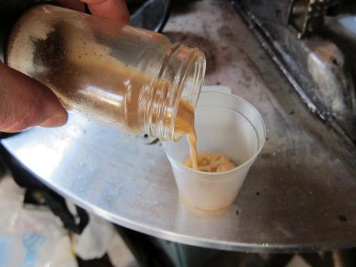

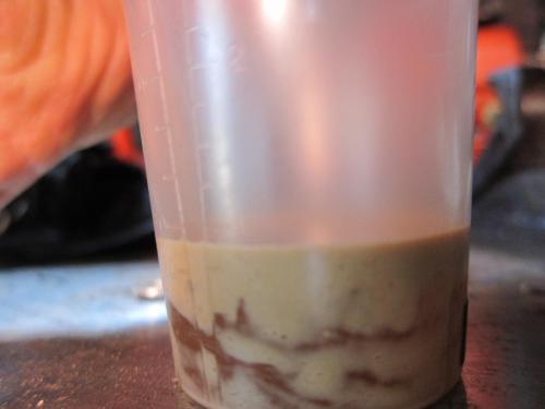

]Finally got around to cleaning mine out today. About an ounce - mostly water.
241 miles total, half that towing 6k lbs.
Sorry about the sideways pic - no way to fix it on this site for some reason. Nothing works.

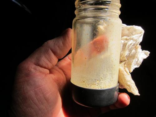

This just about exactly 1,000 miles. Not sure what it mainly consisted of, but it sure smelled like fuel. I don't let the truck idle more than a couple minutes tops when it's started outside after work. From home it's in a garage, so hardly any idle time.
I would say average outside temp was in neighborhood of 30F.
Cold temps will always create more water and more unburnt fuel. The fuel comes from cold start enrichment and IAT temps provide the PCM data for fuel tables, so the colder, the richer (fuel economy always goes down in winter/cold temps).
The water is due to the condensation in the crankcase and the water released during the intense heat and pressure of the combustion process. That is a nasty mix of compounds demonstrating just what would be left to mix and stay in the oil as well as what is ingested in the combustion process when it is drawn in.

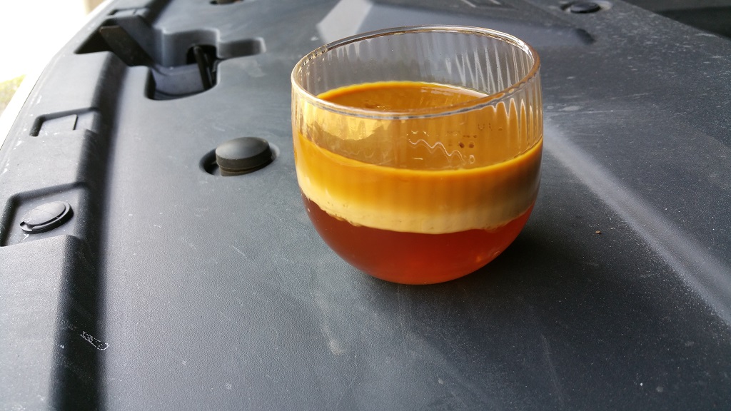

I have been collecting this gunk in another cup and i almost have 3/4 of a cup now. From what I can see when it separates, only a small portion of it settles on top as oil, the rest from what i can see is water and something else. I will take a picture of it another time when it settles. It seems not all of it is oil but other liquids.
Correct. The "mix" you trap should consist mainly of the following, and when let sit for several days will separate into different layers of each.
Water in cold climates is #1. Unburnt fuel #2. sulfuric acid #3, and oil #4.
Of course there is ash/soot/carbon also mixed in with it but that does not separate like the rest. Oil will always be the top layer.
