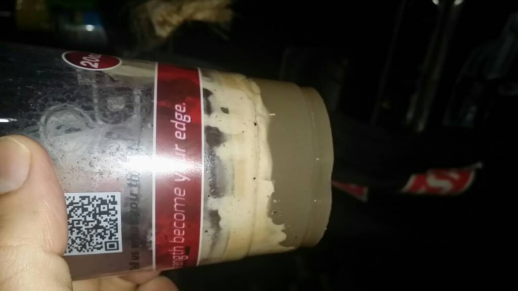

I had my catch can on for less than 1000 miles and I collected this so far.
I should have put a catch can much sooner.

Correct. Most cans (99%) only trap a small portion of the contaminants as they are very ineffective in design. Almost none take into consideration all the principals of flow dynamics, etc. so even those with coalescing media inside, or baffles, rarely take into consideration what will allow the condensed liquids to still be carried back out with the exiting flow. If the media is within 3" of an outlet, most will be pulled back out a cans outlet as the Bernoulli Principal and the Venturi Effect pick up liquid and carry it with the flow. Plenty other factors come into play, and nearly all are designed purely from assumptions the can designer thought works. Look at a Moroso can for example, (and many others with the same design and construction just labeled different) and you will see two chambers filled with coalescing media. The inlet and outlet are not designated, so no direction of flow specific. The side you use as the inlet will trap these effectively, but the side used as an outlet will saturate as well and as it is tight against the outlet (not the 3" minimum needed) it is the same as taking a wet wash cloth and placing it to your mouth and sucking. You suck water right from it. Now imagine the much stronger and greater flow out of the can...it pulls most of the oil and other compounds right back out. Then you have to look at internal volume. Anything less than close to a quart cannot allow the velocity, or speed of the flow through to slow to the point of the condensed/separated droplets to fall from suspension.
Tons more go into a proper effective design, but will save that.
