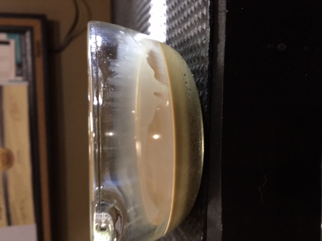

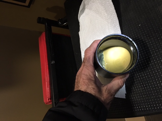

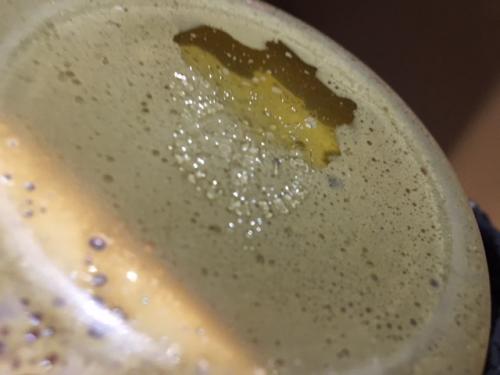

I put on my full Elite system at about 4.5k miles and have put about 1k miles on it, including two drives of about 6 hours at 70+MPH in temperatures in the single digits. When I emptied it for the first time, the Catch can had maybe an inch of crud that I poured out in a glass bowl -not a pretty sight!
My darn phone pictures turn the shots -the first is looking in the can, the second is looking at the side of the glass bowl and the last is looking up though the bottom of the bowl.
