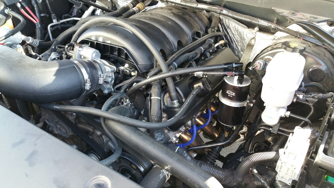

Forgot to post these when I installed the can but here is my dual exit catch can installation. GDI, thanks for your help and input on these catch cans!
The check valves go on the 2 outlets (outer fittings) and that will control flow. There is no way for any of the gunk to flow back into the crankcase due to the design, but great question.
The AN fittings work with either standard hose or the braided lines. Use a bit of grease for both to make inserting and tightening easier.
