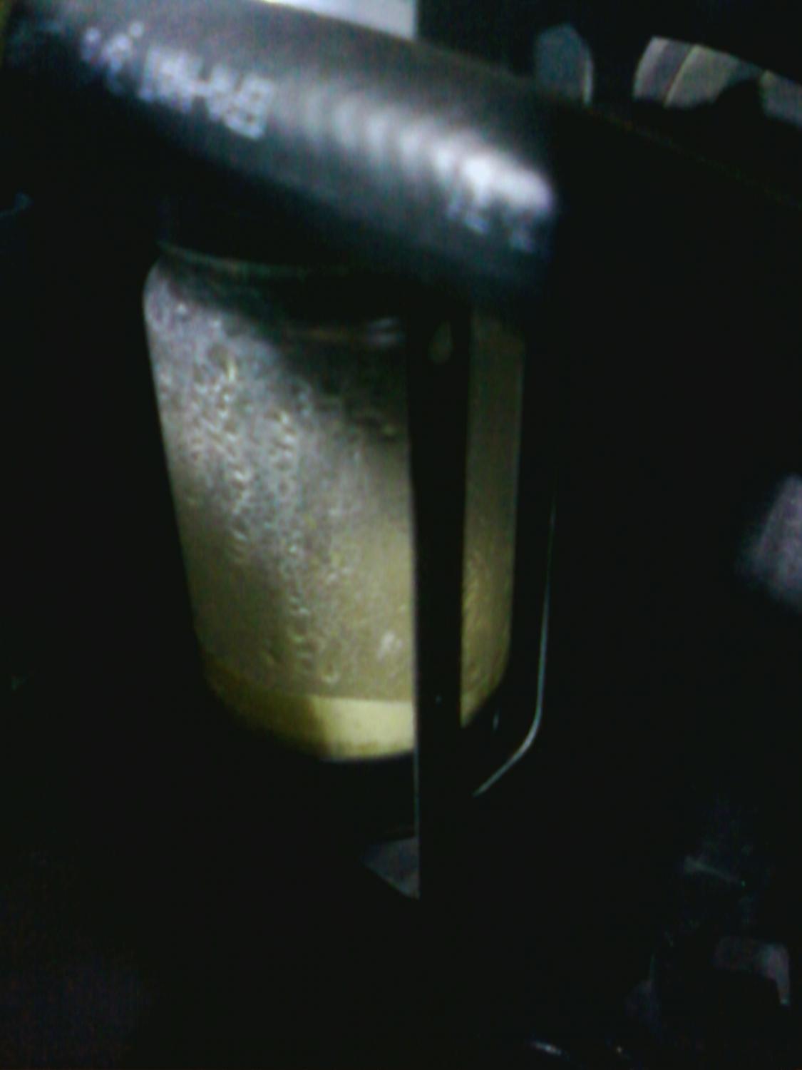

Yep - that time of year again:

I threw a catch can on at roughly 1000 miles. Since I live in the northeast and we've had a lot of cold days Im sure there's condensation in the catch can as well. The can is roughly the size of a coke can and in just 1200 miles( I'm at 2200 total) the can was full. Same color as ^^^ Macks. Def glad I installed it early. I cringe to think of this crap getting into the intake and cylinders

Not sure have far north in the northeast you are but in the winter you will probably want to start emptying sooner. In cold temps they will easily fill up in only a few hundred miles - especially if you're taking shorter trips.

Massachusetts, yea that's what I was thinking. It was about 1/2 from the top. I'm sure some made it past since it was so high. Didn't think it would happened in just 1000 miles but def gonna check a whole lot more

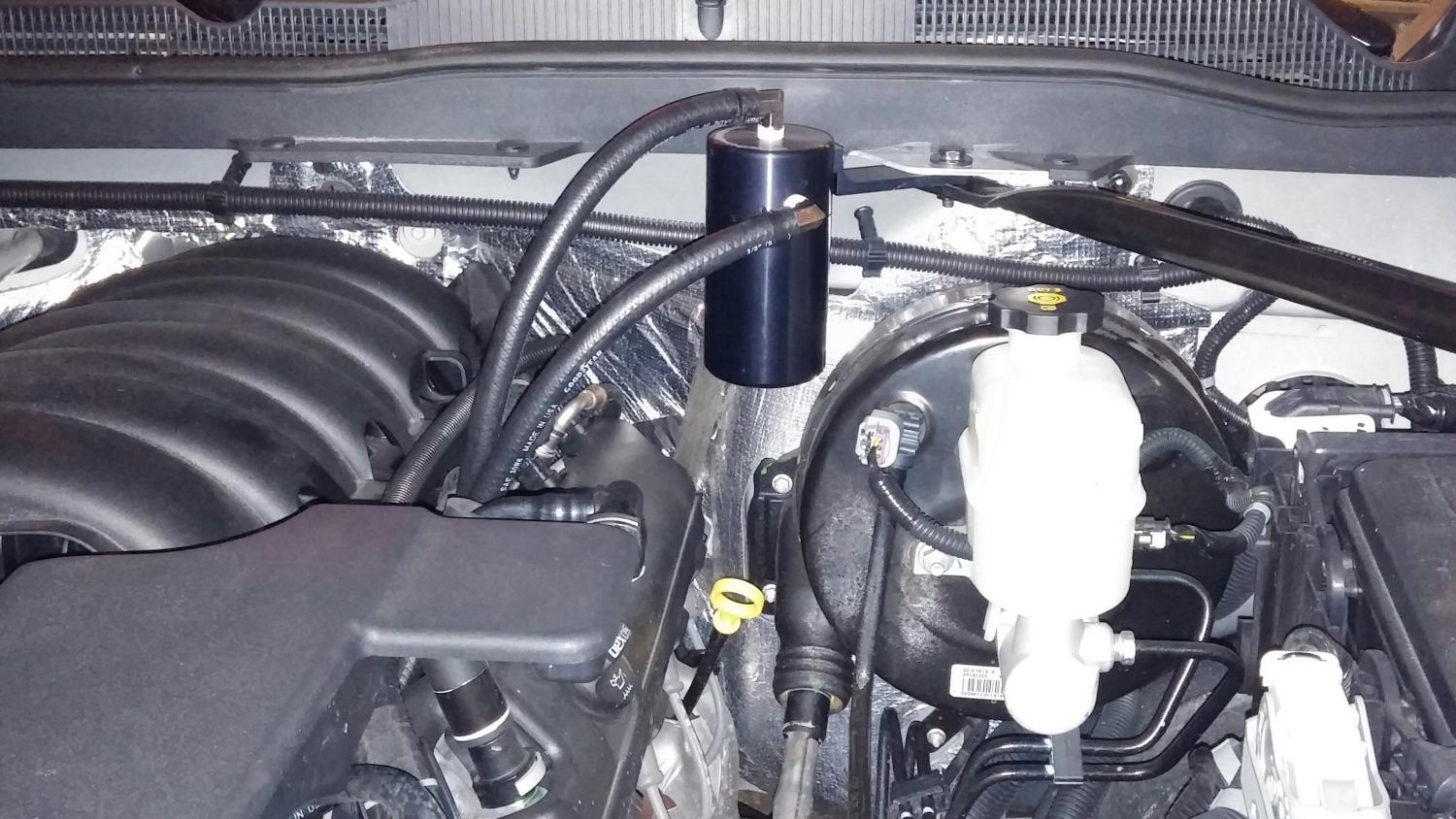

Has anyone done a comparison of condensation buildup between a can mounted above the exhaust manifold on the brake booster, and one at the spare battery location? I ran my temperature gun on those locations after a long drive at 35f ambient air temp. The truck was still running, and I popped the hood as soon as I got home and recorded the temps. The manifold was 89.5, the BB was 86.4,and the spare battery tray was 52f. That's a 34.4 degree difference. So my question is have people noticed less condensation in the winter at the brake booster location because of the hotter temperatures? I'm wondering if the spare battery tray would only be beneficial in the warmer times of the year.
I put mine there mainly because I figure the longer the length the oil mist has to travel, the less likely it is to end up in the intake. I can deal with frequent emptying for 4 months a year. Good part about having the glass can on the Conceptual Polymer unit is being able to see when it's time to empty it. I don't drive the truck much, so I could go 2 months before dumping it.
Either way, I believe the condensation is a result of a cold engine block, so locating the catch can even 1" from the exhaust manifold won't make a difference, aside from maybe introducing some steam into the intake.
Mine is mounted up higher between the engine manifold and the brake booster and mine collects a ton of condensation in the winter. If the manifold location actually works it'd have to be closer than mine is. In these cold temps my can in barely warm after a 35 mine drive.
That's probably the hottest part of the engine compartment too - up high and towards the firewall.
I checked mine after a long highway run towing a car to FL. Somewhere in AL in the 80's outside - underhood temps were HOT. Don't know exactly, but guessing well north of 150°, for sure. Can was ambient to the touch.
I just got home from salting some parking lots (I do snow removal) and my truck was idling for 30 minutes. At your location the temp was 131.3, at the brake booster bolt it was 142.7 and 238.4 at the manifold. At the spare battery tray it was only 2 degrees cooler than your location. The ambient air temp was 32 degrees. Thanks for your response, and picture!
