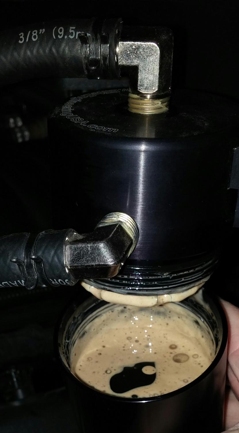

I fought through the cold and looked through about 40 pages of this thread today to better understand how to install my E2-X can. Well it all paid off!! Without receiving instructions in the box I have to thank all of you for helping me with this one!!
Now I will see how much orange slime builds up in our -15 degree Wisconsin winter. Also gonna see what Tupperware I can take of the wife's to use to empty this in [emoji12]!!
Great job! With the cleanside line added connecting the 2 valve covers together, you will want the cleanside separator though that replaces the oil fill cap.
Looking at the results and how after it sits a while and separates, you can see that the only oil is the top layer. The rest is sulfuric acid and water on the bottom, unburnt fuel and water in the middle, and oil on the top. See how dark it is? That is the abrasive soot/carbon/ash contaminats you are now removing from the engine oil and crankcase as well. Keeps oil cleaner longer.

Not even 3 days worth here in MN with sub zero temps through the day. Looks like I will be shortening my emptying interval...
It would be great if elite engineering came out with an larger reservoir for those of us that already purchased the standard can
Sent from my SM-G920V using Tapatalk
Does anyone know how full it would be before it starts sucking thru? Mine was about 1 inch before the threads when i last emptied. Im checking it every couple days now it's filling so fast.
If you look at my picture in my earlier post it was a little below the threads. I pulled the hose off leading to the intake and it did have some of the slimy gunk in it. So I think it sucked some in. So what is this BG or whatever cleaning that's been talked about? Where do you have this done at, the dealer?
Crap that isn't good to hear at all. Mine was super close to that, if not the same. No idea how long it was at that level either. Wouldn't it be expected that the line would have some funk in it anyway because this can is not catching 100%..

I don't know if I should be happy it's catching this much or sad my truck is probably ingesting this gunk in the gulp fulls. This is from 3 days and 205 miles of driving in teens to twenties temps. Looks like I'll have to be diligent about emptying daily. At this rate I honestly can't see the E2-X being a big advantage capacity wise. From Elite's website the original can holds 8oz, the 2nd gen 11oz, and the E2-X 12oz. It'd still be full by weeks end especially if it actually catches more. So my dilemma, keep my 8oz can and get BG service done at the 15k intervals at $99 a pop. 3 times will pay for an E2-X so just pony up now for it. Does using the E2-X negate the need for the BG service all together? That still will not solve this cold weather issue though. I suppose ditch the can during the winter months or all together and keep up on the BG cleanings. It'd be hard to actually ditch the can I think since I've had first hand experience what the build up can do over 100k miles on our previous Acadia. I don't wanna go thru that expensive mess again. Is there anyone who lives North and who has the E2-X able to chime in here on how quickly it's filling up? Elite if you are listening what do you suggest for us in Northern states or Canada to do? Right now I'm forced to empty the can more oftern than I fill up with gas. Its not practical. A great functional piece of hardware but just not practical in cold climates.
