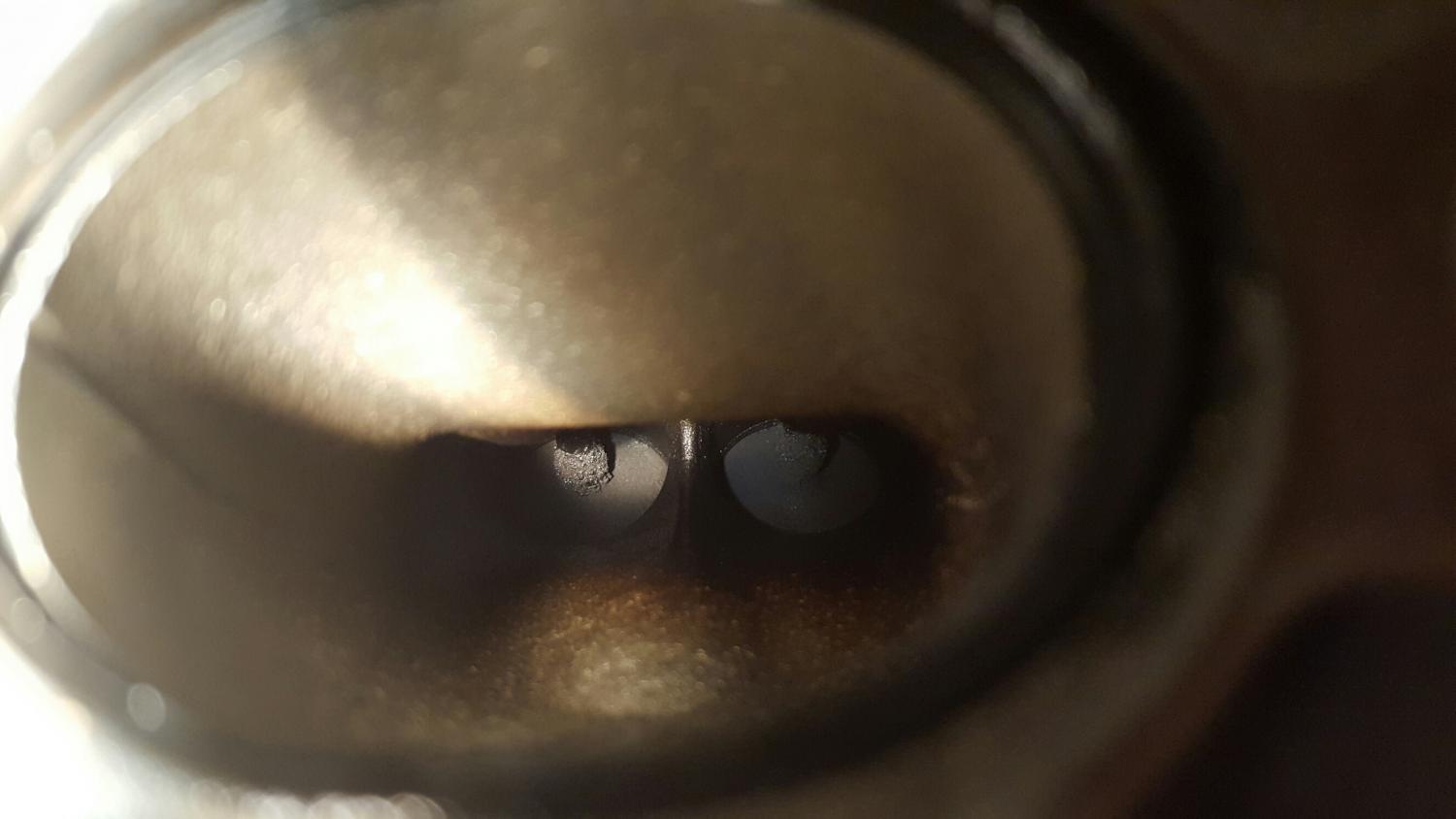

Just thought I'd post some pictures of the valves in my wife's Acadia at 30k miles. I manually cleaned the valves yesterday before adding an Elite E2-X catch can. After seeing this I'm glad I manually cleaned them (not a spray cleaner - CRC or Seafoam) and installed a catch can. I can tell a difference in acceleration after cleaning the valves. We'll see about any mileage improvements in a few weeks/months between cleaning the valves and the catch can.
I've had the standard Elite can on my truck since about 800 miles and upgraded to the E2-X can today (performers better with GDI engines - so I'm told/read).
I guess I can check them in another 3 years/30k miles and see if the catch can helped any! I think it was a good investment.

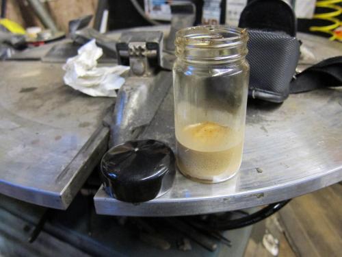

What does the temp difference help with? I'm from Wisconsin where my truck can sit out in some pretty cold temps. I've held off with my purchase not completely sure if the cold weather could have any negative effects. From some of the pictures it looks as though the can can catch a lot of condensation and oil in the winter. Anyone have any freeze ups from an E2x can?
I'm in Minnesota (go vikes btw) and I've been running an Elite can for a few thousand miles now. I haven't noticed any negative effects from the cold (although this has been a mild winter)
The one thing to be aware of is the amount of condensation. I have a short drive to work so I have been catching a lot of water - which means emptying the can after only a few hundred miles.

From what I've read the cooler the can is kept the better it will condensate the oil vapors. It was 35 degrees ambient air temperature when I took the readings immediately after parking the truck. On the brake booster it was 86.4f, and it was 52 degrees at the spare battery location. You'll have noticeably more condensation in the can during the winter especially if you take short trips.
Yep - winter time nets me about 3x more moisture than summer.
