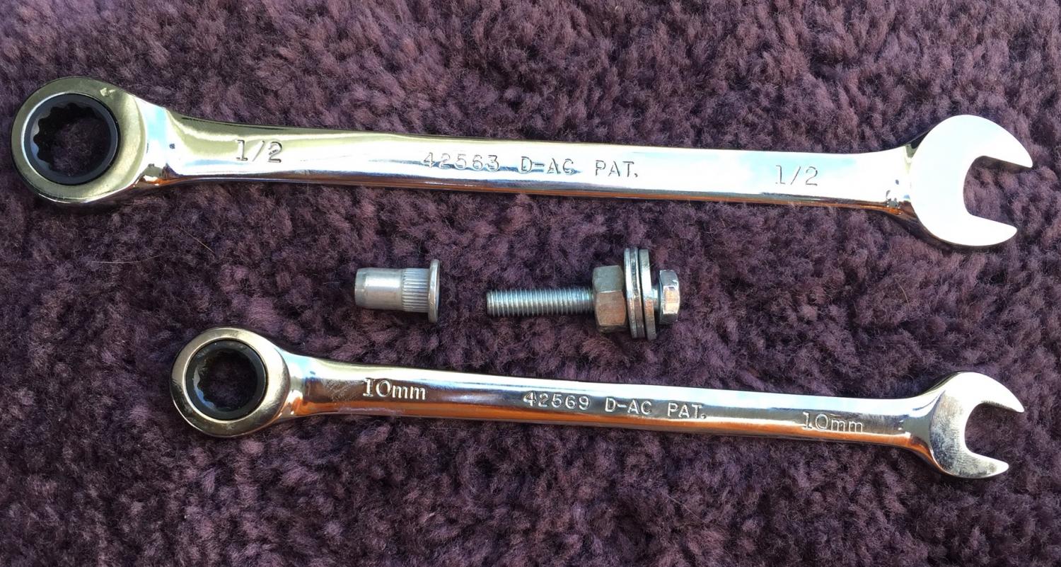

For anyone on the fence about the OEMs because of the rivnut, don't worry. Go ahead, the rivnut is not that big of a deal. I just put the fronts on today with no issues.
Buy an M6 bolt at Home Depot and buy or find a nut that is just a little bigger ( loose on the bolt) and a couple of loose washers. I drilled with an 11/32 drill bit ( calls for 23/64) so I had a super tight fit. Threaded the made up rivnut tool into the rivnut and then tapped on it to seat it into hole. Rivnut didn't spin as it was tight. Rotated bolt 3 complete turns will holding nut to keep pressure against rivnut with another wrench... Done!!
