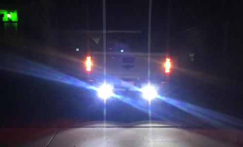

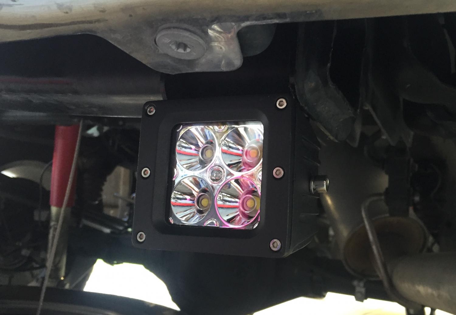

Update on my reverse pods. So I created a spacer for the flush mounts I have in my bumpers. It angles the pods up higher and really lighys things up behind me. I am thinking of ordering a bunch of flush mounts and getting them chromed and sell them with this spacer. Thoughts? Interest?
1e243213092a7b212a83402a5449e523.jpg6bd5c17f8232b725d2ebe42d3f609d03.jpg70aa7f9f97d78b858d85b45505061b41.jpg
I'd be interested. You mean the spacer so the light and mount sit perpendicular to the ground rather than sloping down towards the ground? What would you chrome, exactly?
Correct, that's what the spacer is for. And I'm not sure what Phil would chrome but it would probably be the black parts.
I say yes, make more spacers and sell them! But no go on the getting pods and chroming them. Most people don't want chrome on these trucks so the chrome pods could easily collect dust waiting for a buyer
I agree on the chrome option as well. What I think we will do is offer the standard black with color matching paint as an upgrade option. Should have them for sale on the site soon. Need to get the mold finished for the brackets.
