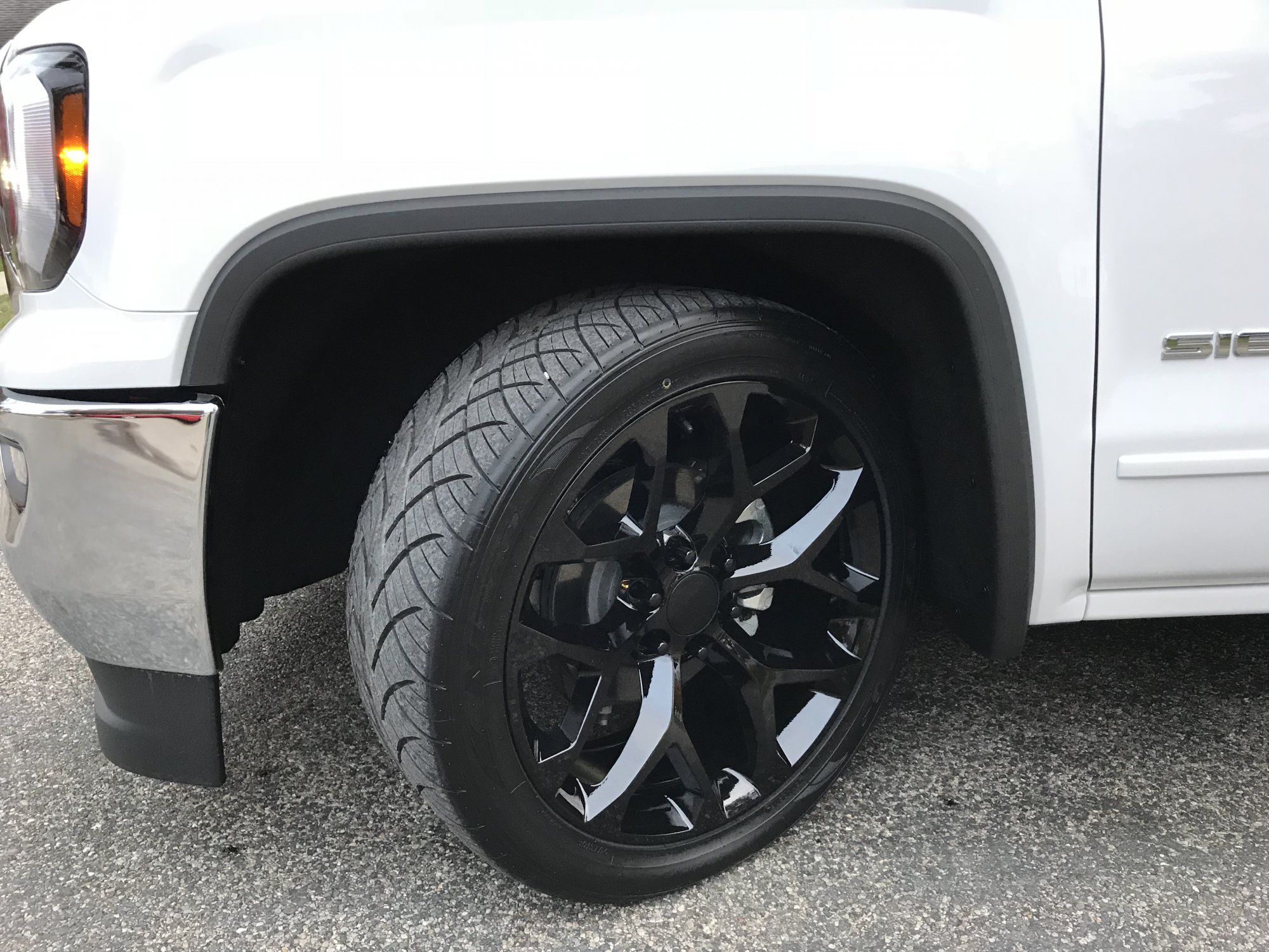

2 hours ago, krunch said:
Are your wheels 24" and what tire size?
Thanx,
Krunch
Krunch, They are 22”. Nitto 420s 285/40/22
