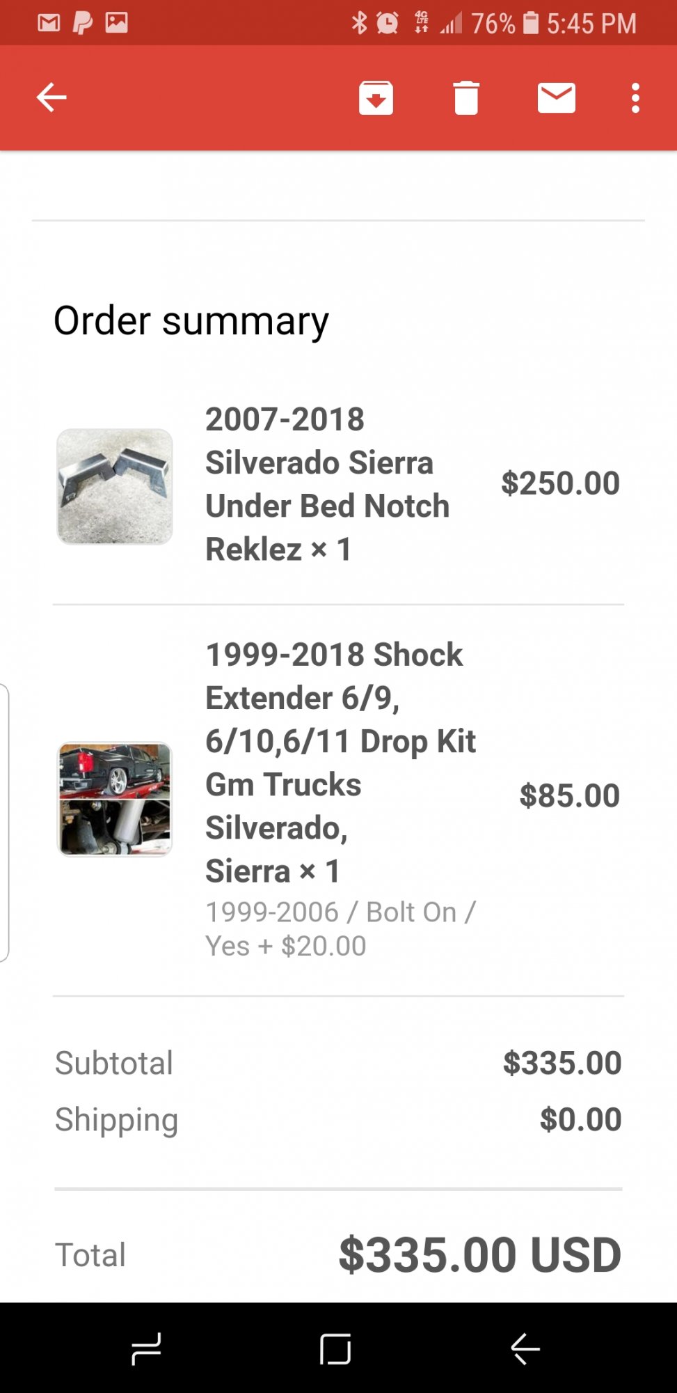

On 10/16/2018 at 3:15 PM, 17gmclowlow said:
Next weekend will be fun.
so how did the notch turn out? mine installed very easily.
Sorry. Been busy. I returned the under bed notch and ordered the monster notch and front and rear tubs. Going much lower than I first wanted to
