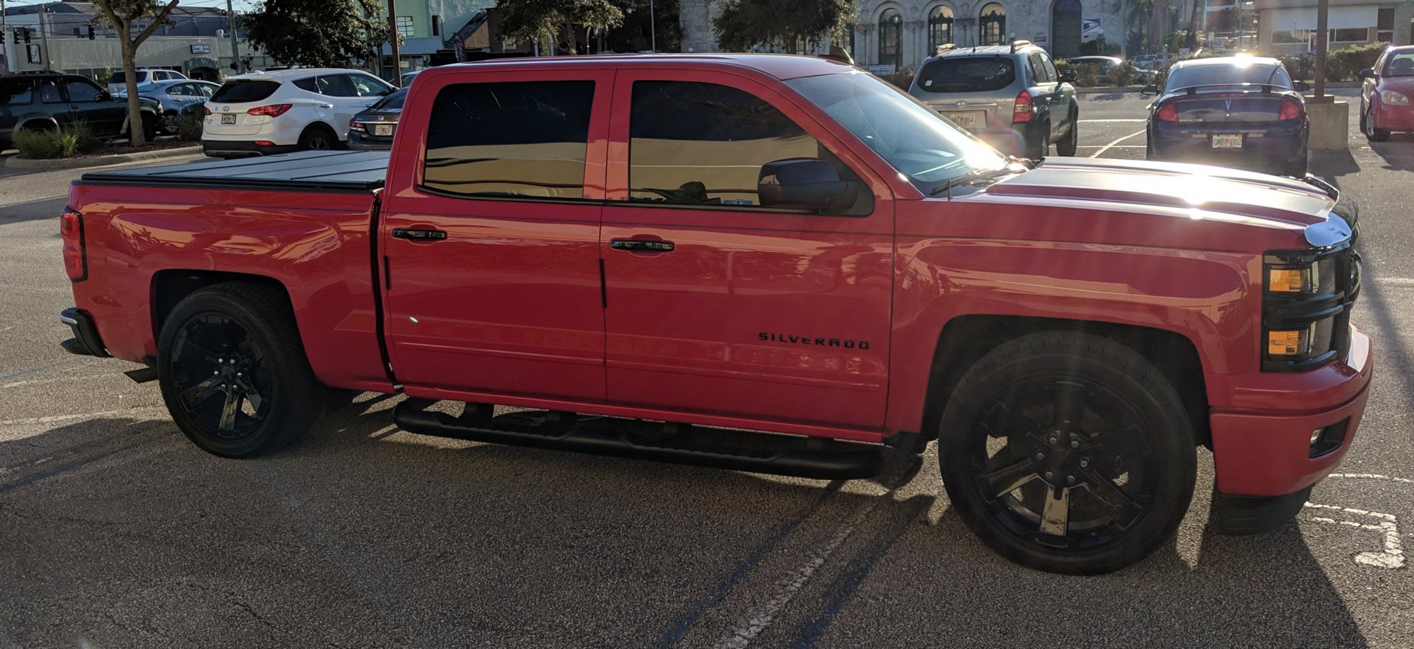

For reference
Are any of you lowered guys losing any turning radius if so how much?
Sent from my SM-G955U using Tapatalk
I actually didn't lose much of my turning radius at all, and I'm dropped 4/6 with 22x10 wheels and 305/40r22 tires. Maybe my truck is a unicorn, but I turn great and only rub slightly at or near full lock.
