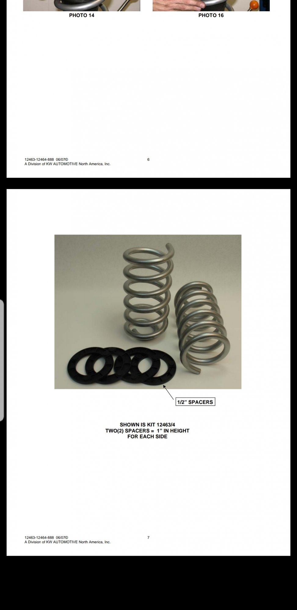

Hey ladies and gents. The 10mm spacer up front on the belltech struts. What's the point of that one? Belltech wont tell me anything besides "it needs to be there for geometry" After I get the money for my c-notch I'll drop more than the 4/7. Do control arms and a new shackle in the rear. But I'm tired of belltech saying "because" and not telling me why. Thanks in advance

True. But I just read the install instructions.  As I didnt do mine. Anyways, they have u install 2 - 1/2" spacers on the strut.  There's the other inch I was wondering about.

What I was confused about is they say
Drop spindles are 2" drop
Drop springs are 2" drop
Struts? Idk 2" drop
That's 6" cause I have all 3. And I'm only dropped 4"
In the pic u can see the spacers they want u to add on top of the struts. That's 1" added. Where's the other 1"??
Did you use the supplied spring spacers?
Just now, qwank said:
I don't have any spacers on my right side strut.
To make up for the lean? I was thinking the same thing.
