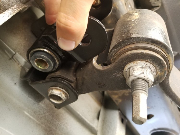

17 minutes ago, 17gmclowlow said:
Yeah, I called had another talk with belltech. They say the flip kit comes with this shackle because the flip kit drops u 7.5" and u need this to bring you to the correct height. I'm going to use my oem shackle and see where it sets me. I dont teust belltech any longer. And then I'll be stuck with a shackle I paid 77 bucks for w shipping. Cause they charge 25% restocking fee plus require you to pay for shipping. I'll end up selling it for a loss if I dont use it. Thanks for your input boss
Ill find kine and send them to you if you want. I just have to find them
42 minutes ago, Nasty said:
I have those shackles in my stash. Tbey are 2.5 eye to eye. Belltech is dumb as shit. Same size as every other 1" lift shackle
I have my oem shackles on the truck now. And my oem hangers just came in today (sitting in the back seat) I'm just upset they told me I needed those shackles when I didnt.
These new shackles are 2.5" eye to eye. That's 2" shorter than the oem shackles. If I keep using the lift hangers which entales keeping the shackles flipped (shorter means drop apposed to oem hanger and longer shackles being drop) will I still get the drop I want? I mean I'm thinking about it in my head. AND technically it should work right? My front end is currently 2" lower than my rear. This should do the trick and I'll be able to return my oem hangers and save 244 bucks. Or am I off on my thinking?
Edited by 17gmclowlow
Eh, I already spent the money. Might as do it right. Lol thanks again for all the help.

Changed out the lift belltech hangers with oem equipment and looks much better. Next for the notch. Damn that's close. Thank God for bump stops. Never thought the pumpkin would be so close to the bed either.
