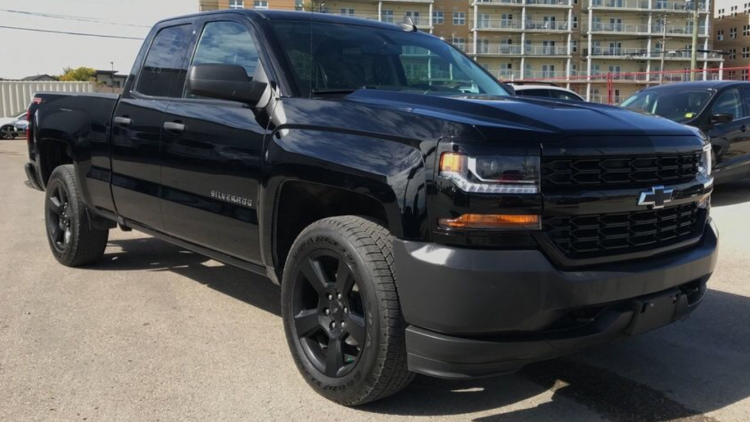

Hey everyone,
New member, and doing research on lowering my 2016 double cab 4WD. There's a lot of interesting info here but seems to be geared more to the 2WD guys. I am hearing from a couple friends that I have limited options when lowering because I am 4WD. I'm not really sure how low I want to go but it won't be extreme. I have looked at many pictures and different "kits" and all I know is I want to be between 2/4 and 4/6. Maybe 3/5? I have looked at a bunch of pictures and sometimes two different brand kits, with the same drop, look different to me. If possible, the adjust-ability factor on a kit would be preferred so I can tweak the height a bit once I can actually see it installed on my truck.
The second thing I would like to accomplish (hoping it goes hand-in-hand with lowering) is to mush up the suspension... probably a lot! I'm a car guy and like the ride cars have. We decided on a truck instead of a trailer for the car that would tow my (less than 500lb) motorcycle, and a bit of lumber here and there. I doubt there will be ever more than 500lbs in this truck and if there is, it won't be for a very long time or distance.
Suggestions for kits, or choosing individual parts to make a great kit would be appreciated.
Thanx,

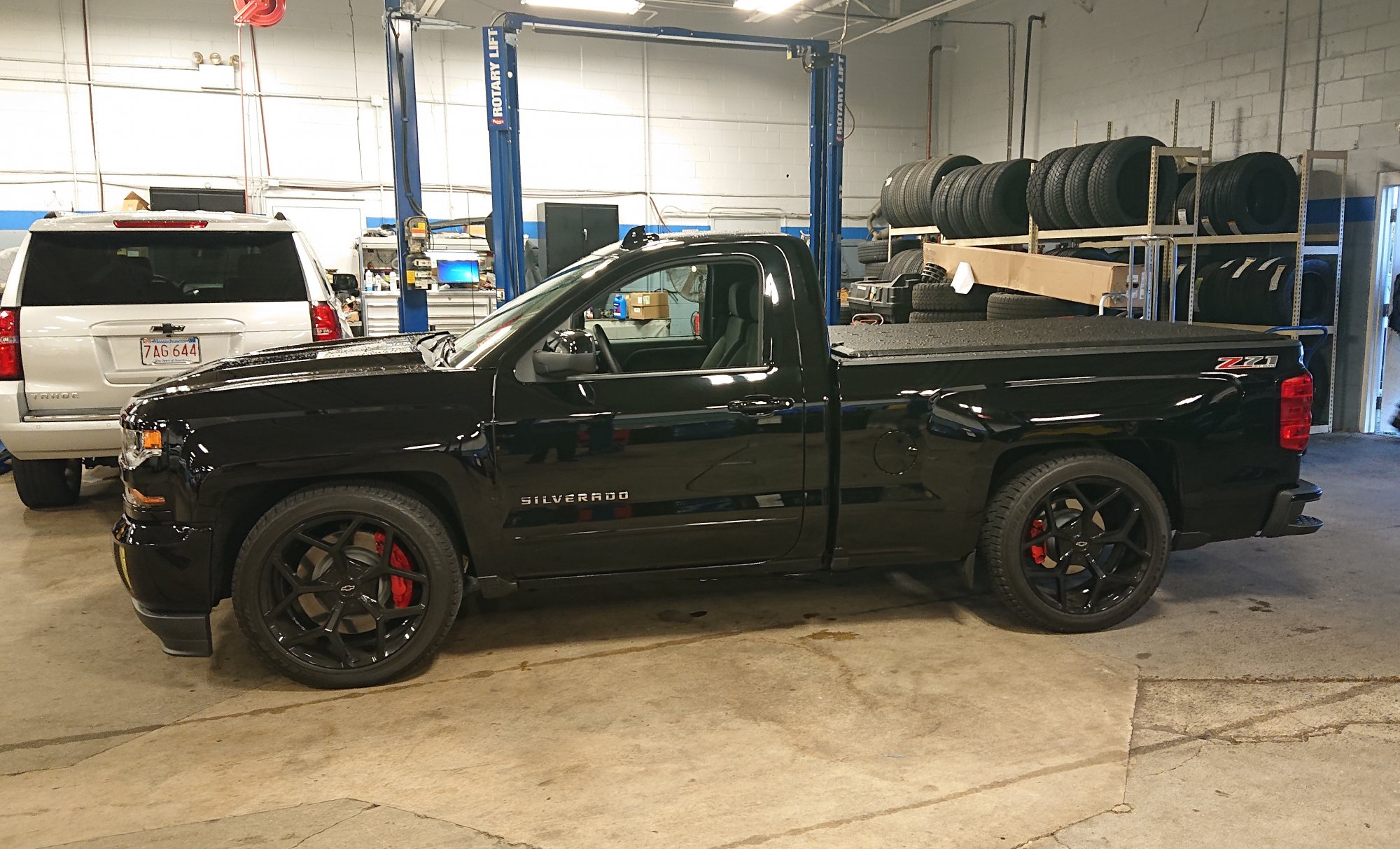

3/5 drop.  Theres options.  @qwank should chime in since he has a 4wd
I have the belltech 4/6 drop on my regular cab z71. The Mcgaughys kit is great too.
Both kits use 2" drop spindles and 2" drop shocks in the front, and an up to 7" flip kit for the rear.
(Insert famous quote)
  • Haha 1
I'm running 4/6 also, but I'm using the mcgaughys spindles and rear flip then added 2"lower springs up front. Still rides like a truck, but from a performance standpoint, a stiff ride isn't necessarily a bad thing. 87f223a1e97edd91f3b3664c6300e943.jpg
Sent from my SM-N950U using Tapatalk
Thanx guys! Trucks look sharp! Are all of you guys 4WD? I checked the McGaugys site and the only kit I see for my 4WD is 2/4?
http://mcgaughys.com/t/2014-2016-truck-12-ton
WRT the ride quality, I do indeed like handling, but if I can't soften up the ride on this truck I might have to look into one of those air ride seats that the semis have. I'm getting thrown all over the place on local streets and I'm sure I can feel every crack in the highway at highway speed on a road that is visibly smooth. Is my problem related to my truck being a WT?
Thanx,
Krunch

You can use 4wd drop spindles and drop struts in front and flip kit with lift hanger and drop shackle in the rear
Good looking truck
  • Thanks 1
This is what I did. Used that kit you referred to, but also used 2" springs to bring the front down to 4" and set the rear flip at 6"
what size tire and wheel is on this. looks really good
If i remember right its a 22 with 305 40 tire
