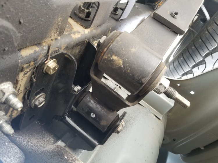

17gmclowlow Posted September 29, 2018 Posted September 29, 2018 (edited) 27 minutes ago, Nasty said: Whats the part number of that shackle. ive never heard of a .5" shackle PN 6404. I'm just trying to get it all correct. Every person at belltech has given me different info. Like damn people. Get ur story straight Edited September 29, 2018 by 17gmclowlow Spelling error
Nasty Posted September 29, 2018 Posted September 29, 2018 36 minutes ago, 17gmclowlow said: PN 6404. I'm just trying to get it all correct. Every person at belltech has given me different info. Like damn people. Get ur story straight Thats a 1" lift shackle

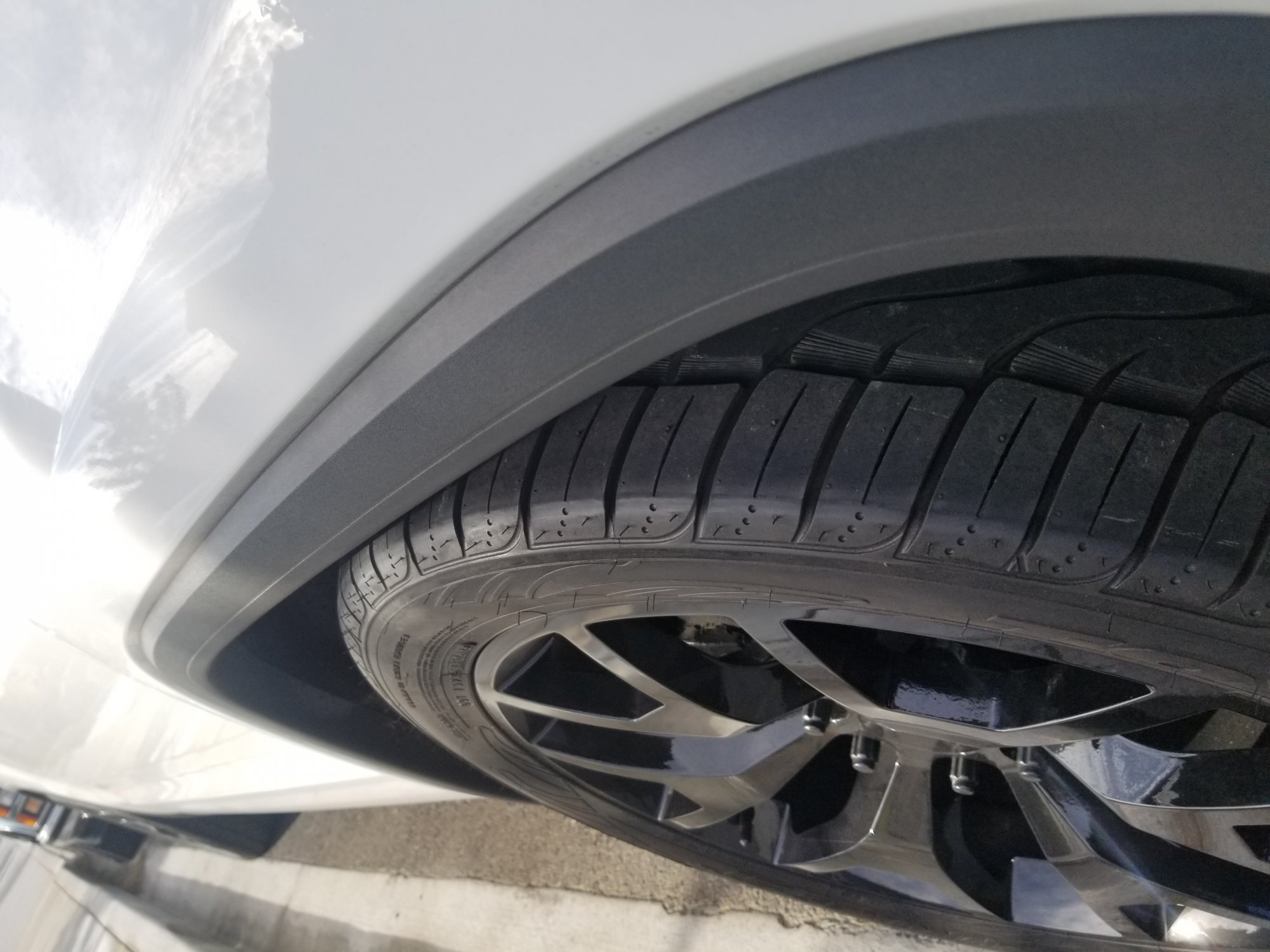

qwank Posted September 29, 2018 Posted September 29, 2018 4 hours ago, 17gmclowlow said: Not sure if anyone is reading my posts. Lol I'm sure its comical. I love fixing what other have done. So after tearing into my front end. I found that schwabs added (3) .8mm spacers on top of the 10mm. So after removing the .8mm spacers, my front end is sitting correctly. I'm very pleased with the outcome. As for my rear end. I ordered the oem rear hangers (because schwabs threw mine away) and .5" belltech shackle so that I can get my 7" drop. My tire up front is too big. (Fender is damn near sitting on top of the tire) Running 305/40r22 toyo proxie 2. Which sucks because they are brand new. But perhaps I'll only have to replace to 2 front and I can still run the same size in the rear. everyone else's truck seems to sit lower than mine with this same kit
17gmclowlow Posted September 29, 2018 Posted September 29, 2018 (edited) 25 minutes ago, Nasty said: Thats a 1" lift shackle Thhose people. I just looked at my email and it says .5" lift. Idk why they cant get their story straight. I believe I'm running my oem shackle right now. Is this the oem shackle? Edited September 29, 2018 by 17gmclowlow Grammer
Nasty Posted September 29, 2018 Posted September 29, 2018 28 minutes ago, 17gmclowlow said: Thhose people. I just looked at my email and it says .5" lift. Idk why they cant get their story straight. I believe I'm running my oem shackle right now. Is this the oem shackle? Looks like oem to me oem measures 4.5" eye to eye 1
17gmclowlow Posted September 29, 2018 Posted September 29, 2018 12 minutes ago, Nasty said: Looks like oem to me oem measures 4.5" eye to eye That's what I got. Thank you sir
17gmclowlow Posted September 30, 2018 Posted September 30, 2018 6 hours ago, qwank said: everyone else's truck seems to sit lower than mine with this same kit Did u install it yourself? If not, I'd look at your struts and make sure there is only 1 10mm spacer.
qwank Posted September 30, 2018 Posted September 30, 2018 9 minutes ago, 17gmclowlow said: Did u install it yourself? If not, I'd look at your struts and make sure there is only 1 10mm spacer. yes I did, I have one 8mm on the left and no spacers on the right to account for the Chevy lean
17gmclowlow Posted September 30, 2018 Posted September 30, 2018 1 minute ago, qwank said: yes I did, I have one 8mm on the left and no spacers on the right to account for the Chevy lean Oh, I learn something new every day. I didnt realize they have a height difference side to side.
Nasty Posted September 30, 2018 Posted September 30, 2018 1 hour ago, 17gmclowlow said: Oh, I learn something new every day. I didnt realize they have a height difference side to side. Should be able to see it,more so on a regular cab.

Dinner Posted October 2, 2018 Posted October 2, 2018 On 9/29/2018 at 5:28 PM, Nasty said: Thats a 1" lift shackle PN 6404 is a 0.5" lift Website states that and I gained that amount when I installed it
Nasty Posted October 2, 2018 Posted October 2, 2018 11 minutes ago, Dinner said: PN 6404 is a 0.5" lift Website states that and I gained that amount when I installed it I have those shackles in my stash. Tbey are 2.5 eye to eye. Belltech is dumb as shit. Same size as every other 1" lift shackle
17gmclowlow Posted October 2, 2018 Posted October 2, 2018 Just now, Nasty said: I have those shackles in my stash. Tbey are 2.5 eye to eye. Belltech is dumb as shit. Same size as every other 1" lift shackle Yeah, I called had another talk with belltech. They say the flip kit comes with this shackle because the flip kit drops u 7.5" and u need this to bring you to the correct height. I'm going to use my oem shackle and see where it sets me. I dont teust belltech any longer. And then I'll be stuck with a shackle I paid 77 bucks for w shipping. Cause they charge 25% restocking fee plus require you to pay for shipping. I'll end up selling it for a loss if I dont use it. Thanks for your input boss
