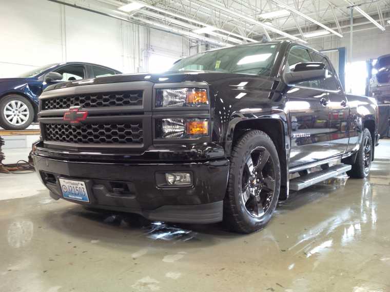

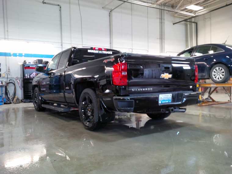

heres my addition to the list. If you guys are painting chrome bumpers make sure the chrome is sanded until its grey. use a really good acid etch primer/acid wipe rag (from a gun not spray bomb) sealer then base. if you just use sealer it will peal. on the plastic chrome I have heard that soaking headlight bezels and the grille in bleach will lift the chrome from the plastic. I haven't actually tested this yet once I get a high country grille I am going to spray the bezels and grille. (currently plasti dipped).post-83457-0-17860500-1403366734_thumb.jpgpost-83457-0-18549700-1403366842_thumb.jpg
