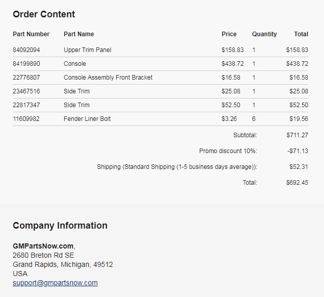

Keep in mind, the used or junk lots are charging way to much for these and it was actually cheaper for me to get it from gmpartsnow.com and all brand new.  Used/junk lot tried to sell me a console without the top for $750 as they know they are a hot commodity for many of us.  I was able to get the full console for $692 brand new with free shipping.

Was this a complete console with everything it takes to install. Thanks Johnny01:

Just missing the 2 USB cables otherwise yea that is the complete console. That’s what I ordered as well
Yes this included everything if you are working on the set up as Phil has it you only need to order two USB cables and his harness.
 I've done the install exactly how he has it and I'm loving it

I found a 2016 that had everything I wanted including match my vehicle and then I sent them the Vin number for it so that they could match it properly
Mines a 2018, ordered the 2018 console which is the exact same as the 2016 except it has the newer version of the wireless charger.
