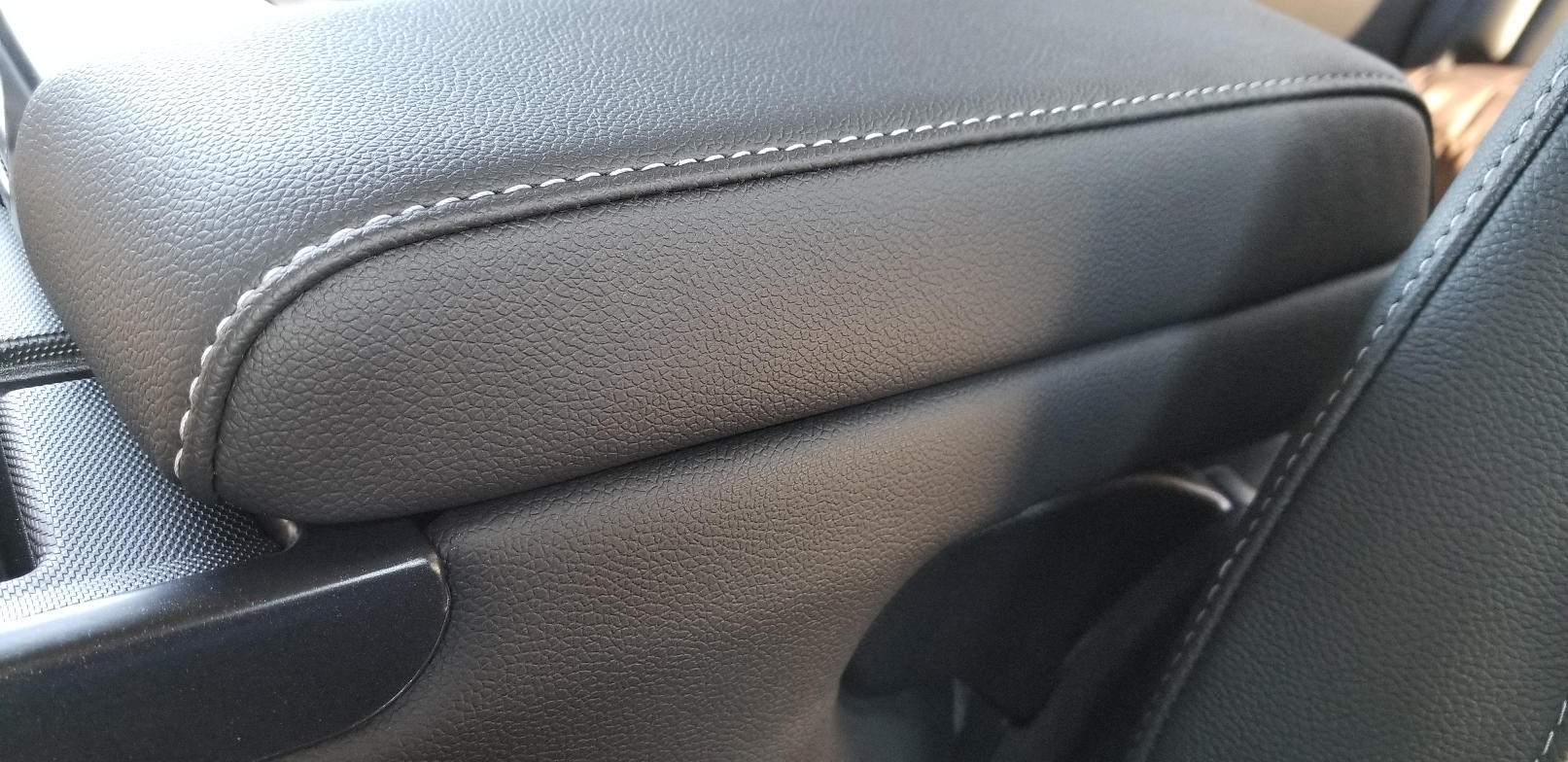

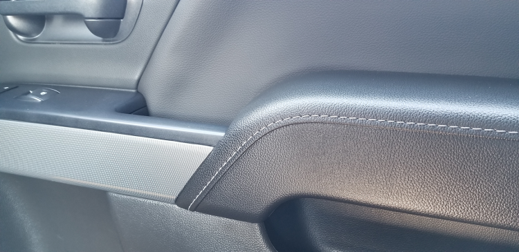

On 4/19/2018 at 6:47 PM, FourThor said:
All done, love it. Best upgrade so far.
Is that the black arm rest with white stitching I seen a grey one today at the dealer that matches the grey cloth seats which you have just like I do but I was wondering if yours is the black lid?

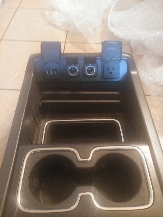

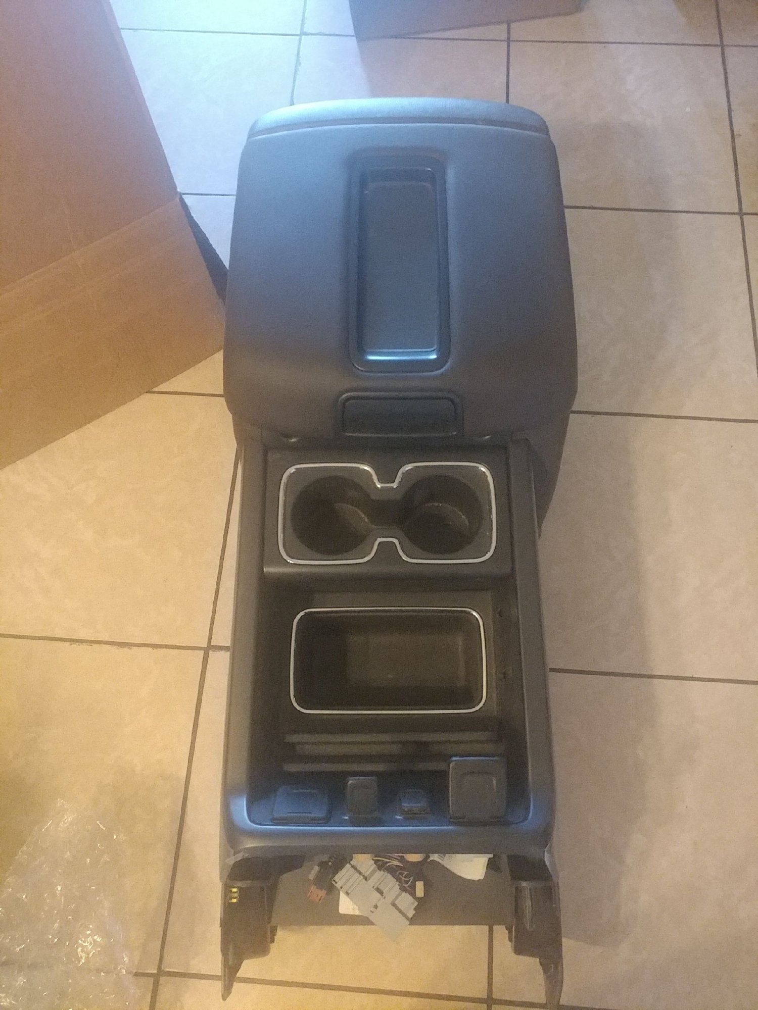

On ‎6‎/‎15‎/‎2018 at 11:35 AM, Hubbstx said:
mitchell95: I just finished my swap. Ordered all partsfrom Corbin with gmpartsnow.com. I spent hours researching prices and they were by far the cheapest to the door. I have a 2018 Silverado Crew with black interior w/silver stiching.
84288040-Console $390.79
84092079-Upper Trim Panel $146.57
22467516-Side Trim $52.96
23467516-Side Trim $25.30
22776807-Front Bracket $16.58
84022323-Cable $16.46
19119050-Cable $24.13
11609982-Bolt x 2 $3.26ea
Total $680.31
10% Discount -$67.93
Shipping to my location $54.53
Grand Total $665.91
You will also need the wire harness from pgamboa he will hook you up...
Hope this helps
Sent from my SM-G935V using Tapatalk
I'm trying to do a console swap in my '18 LT crew with Jet Black leather appointed interior. I was duplicating this order but 22467516 isn't returning any matches on GM parts direct when I search for it. I have every other item in my cart.
Also, where's the 10% discount from?
Not sure why that part # isn't working, but that is the driver side trim for the console. I would get ahold of Corbin @ gmpartsnow.com he can get everything that you will need. As far as the 10% discount I had everything add to my cart trying to decide to buy or not for a few days. After a few days I received an email with a 10% off. Hope this helps
