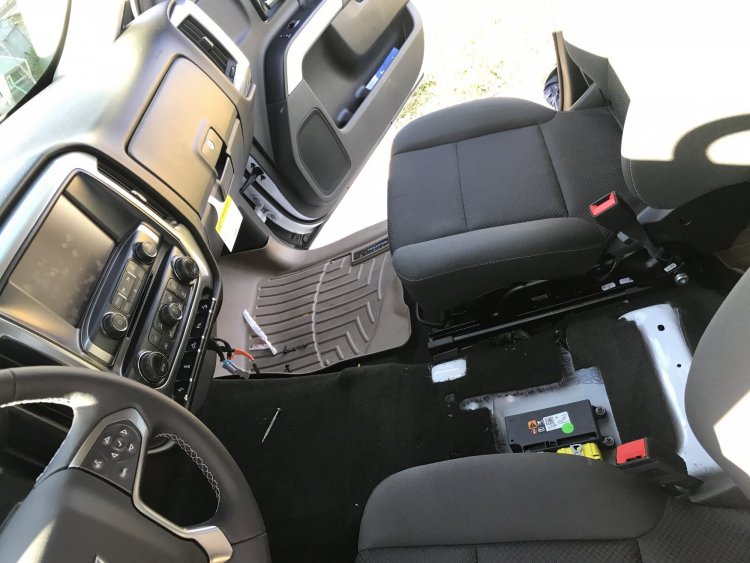

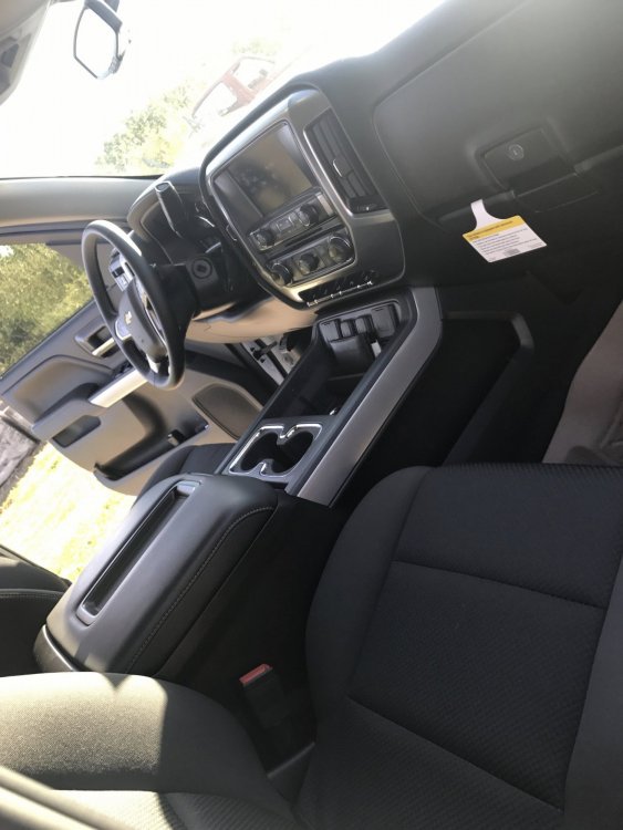

Finally got mine in. Went good but I waited to check everything till it was all assembled. Seems I don't have any USB but everything else works. Work on it next weekend hopefully it will be a little cooler out.

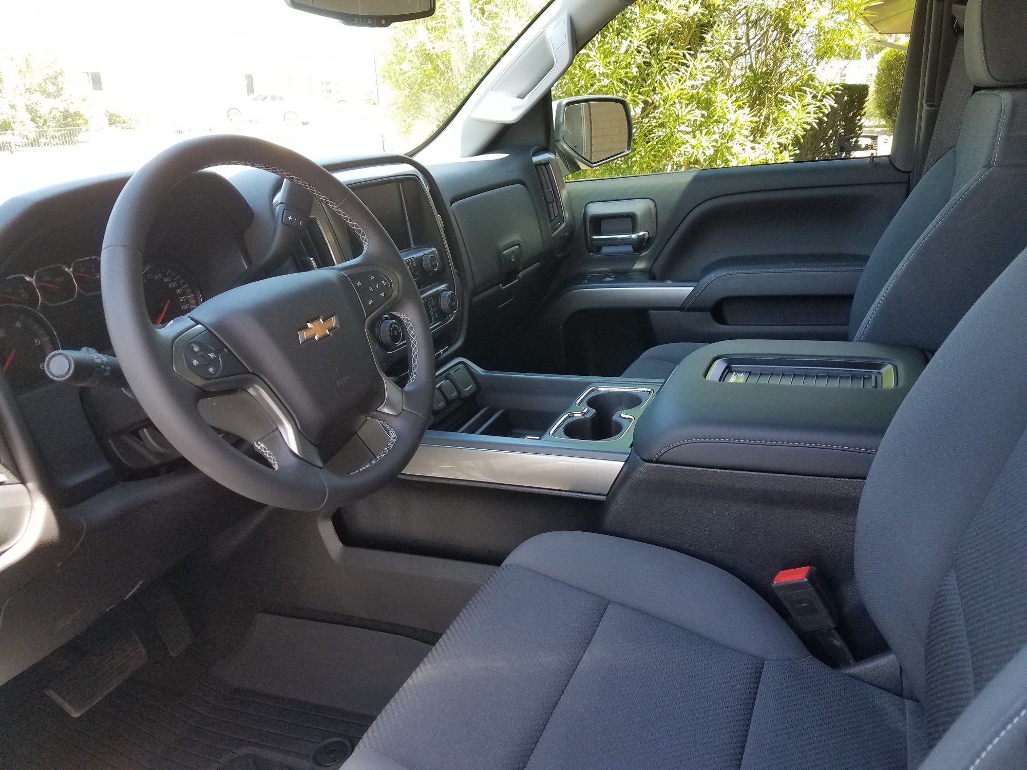

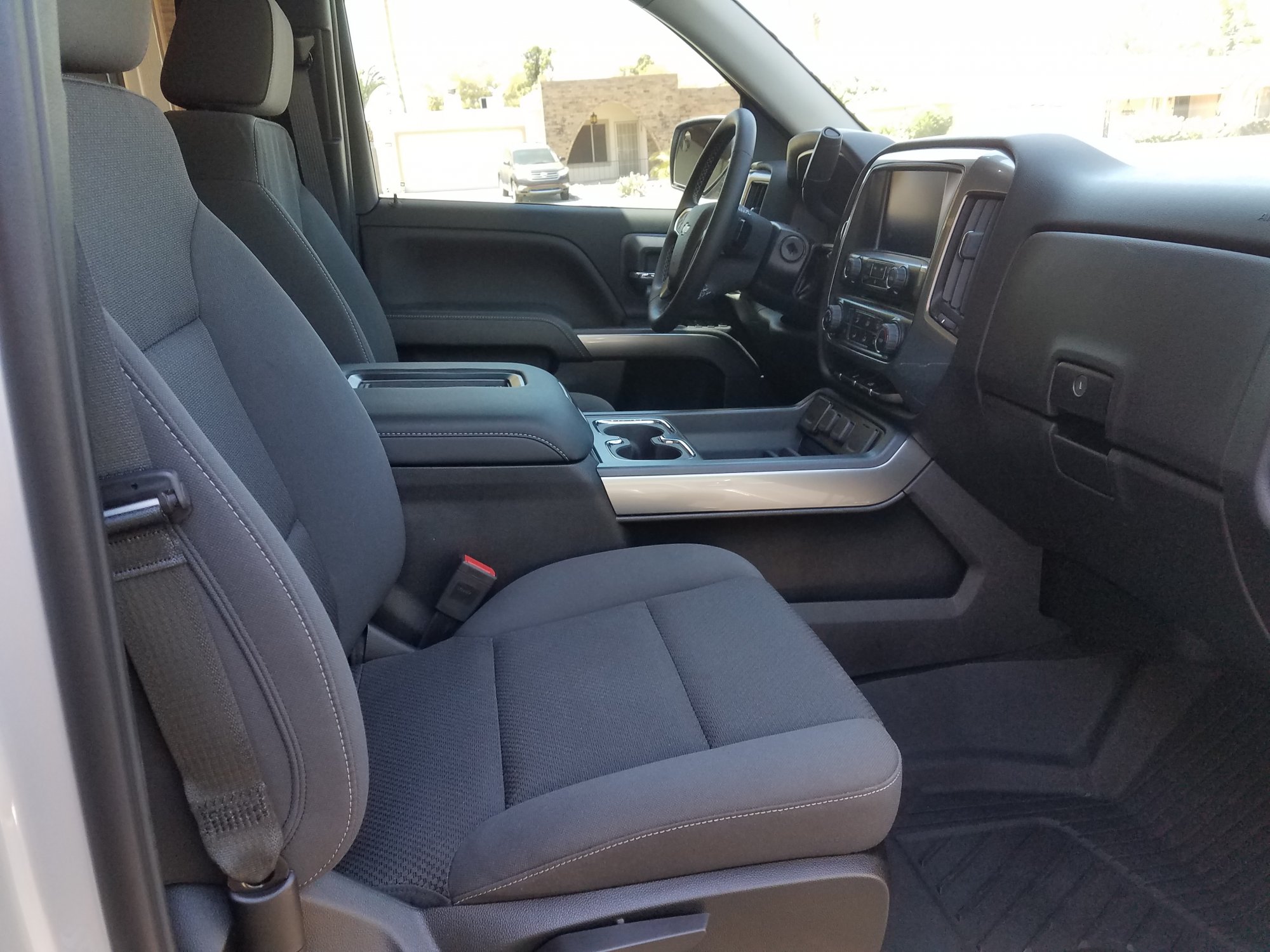

Got it installed. Everything works like factory. Phil thanks for the harness! It made the install very easy and straight forward.
