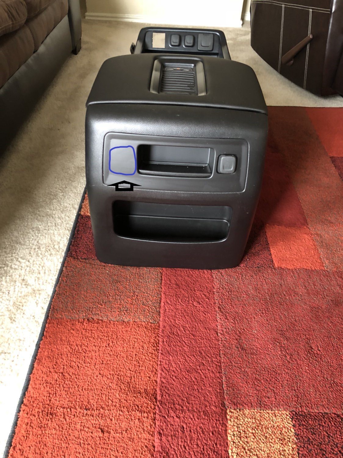

Looking at 2018 LT Z71 trucks now.   One question that maybe someone can answer.  Has anyone looked at adding a 2 port USB like on the front of the console to the rear opposite of the 12v plug?  See the picture... Would not have to have the full connectivity, just charging...  I will be putting a console in a new truck if I do not get one with it...
Looking at doing that to mine.  Actually, looking at (already have the parts for) replacing the DC outlet with a tandem USB outlet and a slave set on the other side, power only on both sides.
Ha! That’s funny using my pic to ask that. Seems like a good idea though for passengers to use
