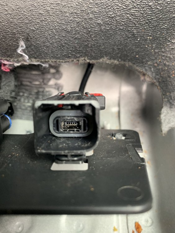

I am looking to find the cables that are needed for just use of the usb for apple car play. My truck is a work truck and no center console. I do not want a center console. I have tried a gray to green cable but it does not fit into the connector that is located underneath the front driver seat. Please anyone can you help. Thanks. I have pictures of the two connections as described.
I have the part number for that cable some where but its just a mini usb in the inside. you could by something like this plug it in then plug your iphone able into that. https://www.amazon.com/SaiTech-Pack-Cable-Digital-Cameras/dp/B00VWUTJ22/
edit: i just remembered the cable your looking for doesnt exist gm doesnt make a cable thqt goes from that connector to usb a femail. It goes that connector to mini usb because it normall connects to the hmi

Yes I do have the USB port that the cable will connect to. The cable is mini usb to mini usb and connects from the picture that I put up to a regular usb factory port. I have the parts except a cable that fits one end into the factory part I took a picture of.

what im saying is you might be able to just take a mini usb and shove it in there with out damaging the the factory plug it should be fairly secure.

Only thing I’m worried about is it if it comes unplugged as I have to remove the seat to get comfortably to the connector.

Do you have the part number for the other cable next to the small connector? I tried my connectors tonight and still didn’t work.
