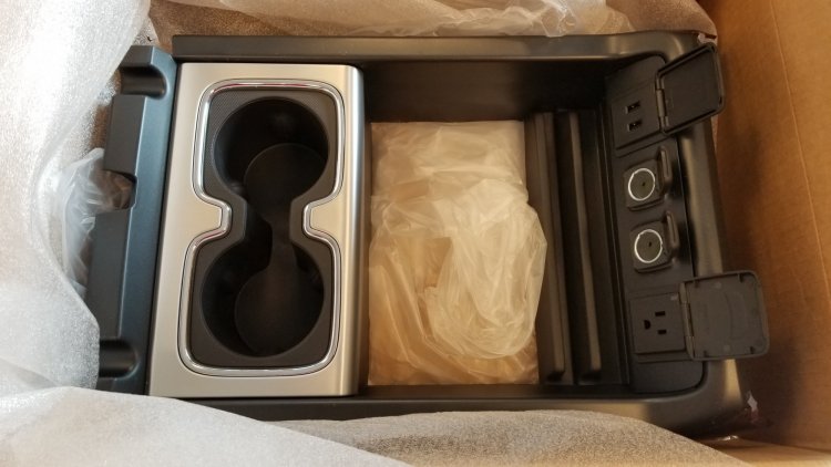

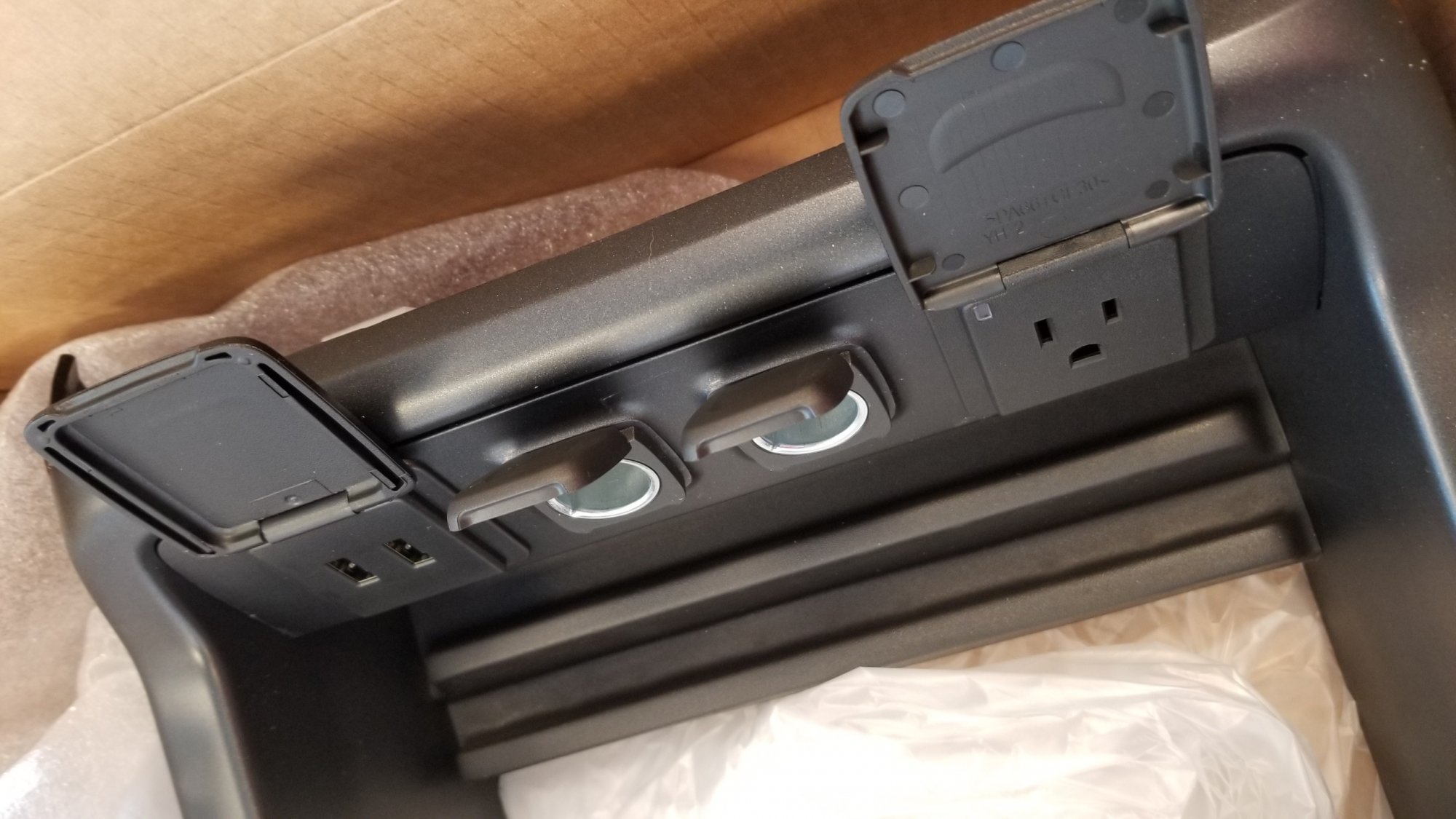

I just received my Center Console in and it's perfect.  The only issue I see is the cigarette adapters the covers only go as far as they are in the picture and it worries me that they can be hit and broken off.  See the Third picture.  I wish they opened as wide as the other adapter covers.  Other than that, it matches everything perfectly including the wood trim and I am very happy.
