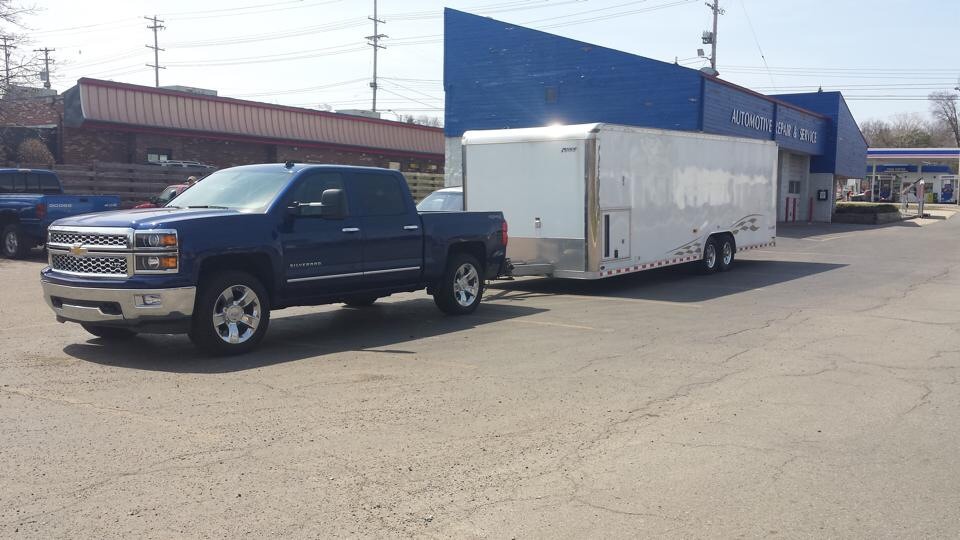

Finally got around to hooking my trailer up for a quick trip across town to unload the drag car at my shop. I have about 1250 miles on my truck so far (6.2 with max tow, only mod was to swap out the stock tires for more aggressive Cooper Zeon LTZ's)
My first impression is holy cow this thing has some balls. I mean it is fun to drive around town unloaded and occasionally drop the hammer, but where it really shines is with close to 10,000lbs hooked to the bumper. It has no trouble hooked to the trailer pulling away from traffic at stop lights or getting up to speed in a hurry when merging onto the highway. I even forgot to run it in tow/haul on the way over. It tows as well or better than I expected for a 1/2 ton. Stability wise it is very good no sway and just a hint of porpoising on larger dips or bumps. You can tell they split the difference between empty ride comfort and towing capability.
The integrated trailer brake works better than any aftermarket unit I have ever owned. It uses the brake pedal position sensor to adjust the output while the actual "gain" or total power is user selectable (I ran it all the way up as my trailer is pretty heavy) one of the nice things I noticed about the brakes were how linear the brake control applied and released. Where you really notice this is moving slowly in stop and go traffic (like waiting in line to get into the track) It comes off so smoothly that you can't even hear the typical chunk noise of the brakes releasing and the trailer isn't jerking you to a stop if you are just lightly riding them.
I will get a bit more time dragging the trailer this weekend when I run the car up to the track for recertification. It is about 150 miles round trip.
For comparison I have owned 2 big block 3/4 ton Suburbans a 99 with a 454 and a 02 with the 8.1 along with 2 Duramax powered Silverados an 03 ext cab with a LB7 and a 06 crew cab with a LBZ. I also towed this trailer with my Dad's 3/4 ton 6.0 07 Silverado classic.
This truck has way more power than the other gas engines it is pretty close to the LB7, only the LBZ outshines it power wise. Stability wise only the Duramax Silverados towed better with the heavier suspension and longer wheelbase. If I planned to tow a lot I would probably add airbags to stiffen the rear up a little.
