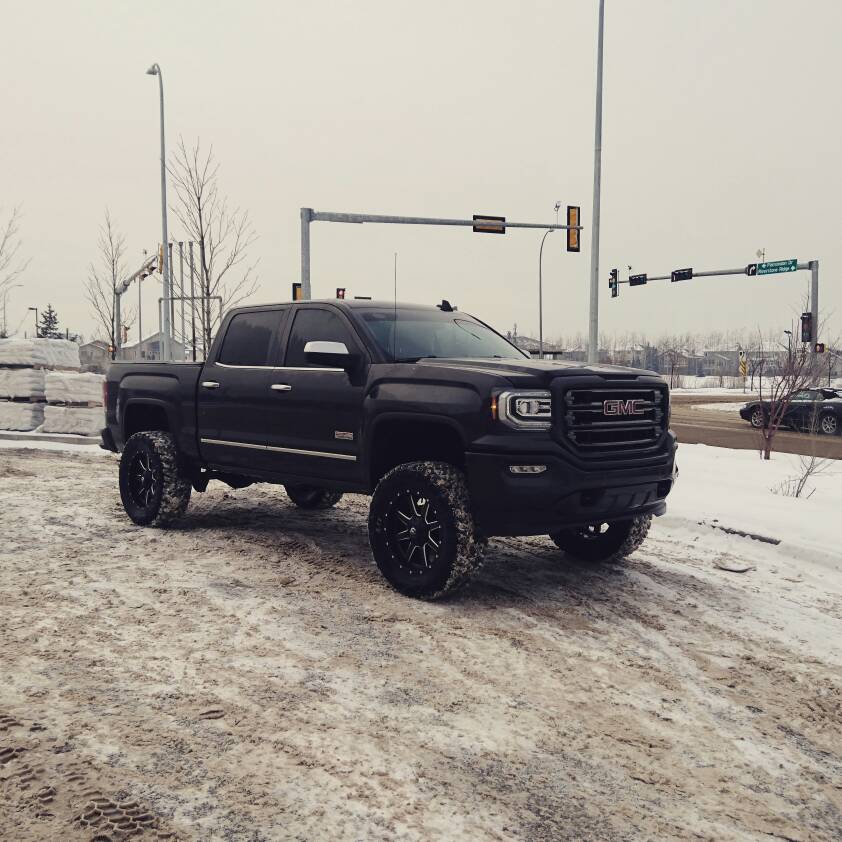

Thanks man, its a 4 inch in the front and 3 1/2 in the back [emoji1419]
Level 8 Mk6 in gunmetal, 18x9 0 offset
BFG K02, 305/65-18
4" Fabtech lift/level
Slight rub only at extreme left/right wheel turn.
Lightly trimmed the front Husky mud flaps near the mounting screw holes.

That's a real good looking tire. Thanks for all the pics. Looks like 4" lift is the minimum for that size and would probably look good with a 6" lift too.

Yes I agree I think 4" is minimum. Hmm now ya got me thinking of going to a 6". :)

the combination is amazing. you got a good but very rare taste :D
