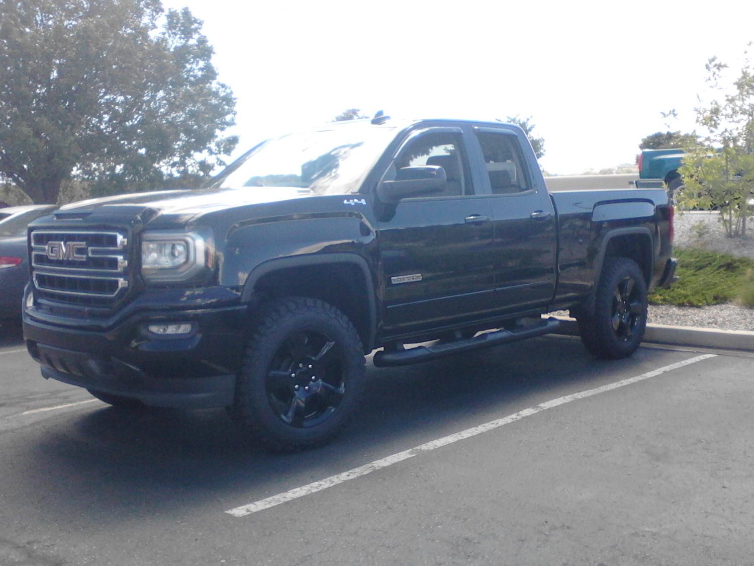

Ended up with the 275/65r20 BFG Ko2 on the stock 20s, super happy with it. Only rubs at full lock, left, on the driver side, in reverse. Just need to pin the liner back and I should be fine. Wish I had a lower offset but some spacers will have to do for now should be ordered soon. Crappy pic and not a flattering angle, I'll take a few more tomorrow. Looks 100% better in person
I may take that plastic piece off of the front bumper tomorrow.. idk yet might make it look a little more aggressive.
be careful with how large of spacers you get. with a 34" tire you could rub the fenders with too much offset.
