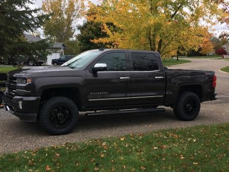

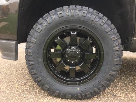

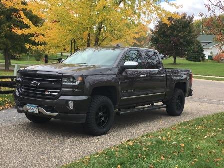

2016 Crew Cab LTZ Z71 with 2.5" RC lift with rear block...
285/65/18 Nitto Ridge Grappler with 18x9 Gear Big Block 18mm offset.
No rubbing whatsoever. Thinking of changing to a 33x12.50 while I still can. Thoughts?

Nice lookin truck! You like the ridge grapplers? They look killer
Thanks! Honestly I just got them put on about 2 hours ago but I do love the look of them and for the short ride home they seemed to be just fine!
