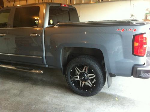

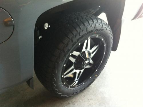

So I wanted to give it a few days for everything to settle after installing the lift and wheels. Front fenders measure right at 40" and the rears are 40.5". The tires are pretty true to spec size wise, about 32.5" tall and 11.5" wide.
How do you like the ride and the noise? My Nitto G2s are horrible on a wet road...have you driven on wet streets yet?
When you are at full lock and hold it, what kind of clearance do you have around the liner, swaybar, and UCA?
Thanks....and nice truck, btw!!
Love the setup, and the look of the RT's! How bad is the rubbing?
not to horribly. My tires are 33x12.5 and they slightly rub sometimes while going foward at 26 degree turns. And in reverse they rub at 33 degrees but don't rub at full turn in either direction.
Nice man. Im trying to avoid rubbing, but geez those 20x10's look great. Going from an nnbs with a 9" lift, 35s and 20x12s to a leveled 2016 is really bugging me. Really hard not to just lift this one too.....
