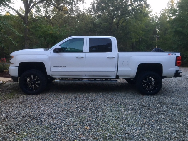

2016 Crew Cab LTZ Z71 with 2.5" RC lift with rear block...
285/65/18 Nitto Ridge Grappler with 18x9 Gear Big Block 18mm offset.
No rubbing whatsoever. Thinking of changing to a 33x12.50 while I still can. Thoughts?
That looks really good. I like those wheels. I think a little more tire would look even better though. I'm surprised those 285/65/18's don't look any bigger than they do.
This is the tire and size I've been waiting to see on a leveled 2014+!!! When you put a tape measure to it, what are the real mounted dimensions for height and width?
I think it looks fine. A 33x12.50 would look beefier but the extra weight and width would have drawbacks in ride, power loss and mpg.

20x10 moto metal MO970 machined
Offset -24
Wrapped with nitto terra grappler g2s
305/55/20
whats your lift setup?
5" rough country bracket kit (keeps stop track width) with a 5.5" block on rear instead of the 4.5" block that comes with kit. So front is raised 5" and rear is raised 4.5" (stock block is 1"). Has a slight rake to it but I love the aggressive stance. Just need some power now! Lol
what are your fender measurements?
Right around 43 1/4 in front and 44 1/4 in back

So I wanted to give it a few days for everything to settle after installing the lift and wheels. Front fenders measure right at 40" and the rears are 40.5". The tires are pretty true to spec size wise, about 32.5" tall and 11.5" wide.
