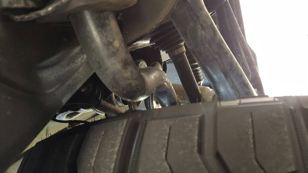

What offset? Any sway bar or control arm rub?
Edit: just saw they were sierra reps so +27, but do they rub? Lets see some more shots and if you could take pics of sway bar and control arm, are they flush with fender?
Here's some more pics. It will rub the back inside corner of the felt wheel well liners at full lock right or left. It's close to the sway bar but doesn't rub it at all. They are about flush with the fender wells. I forgot to add that this is with a 2 1/4" Pro comp leveling kit.post-54656-147837967665_thumb.jpgpost-54656-147837968637_thumb.jpgpost-54656-147837969379_thumb.jpgpost-54656-147837969925_thumb.jpgpost-54656-147837971428_thumb.jpg

I'm getting those same wheels but in all black and 295/55r20. Any rubbing on control arms or sway bar? Also looks great!
Thanks. I have a slight amount of rub on the sway bar at full lock in reverse. I zip tied the fender liner back prior to install.
