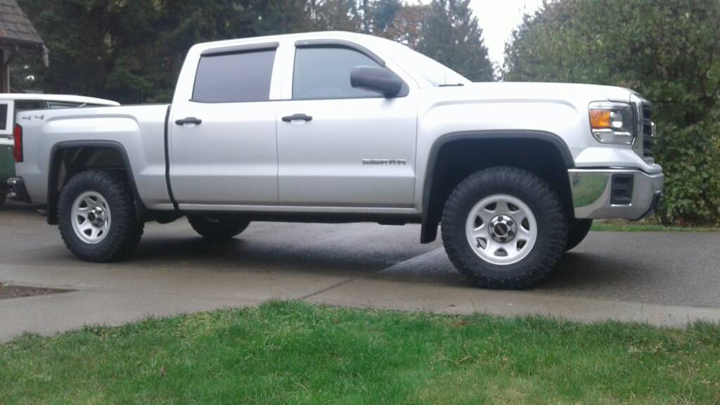

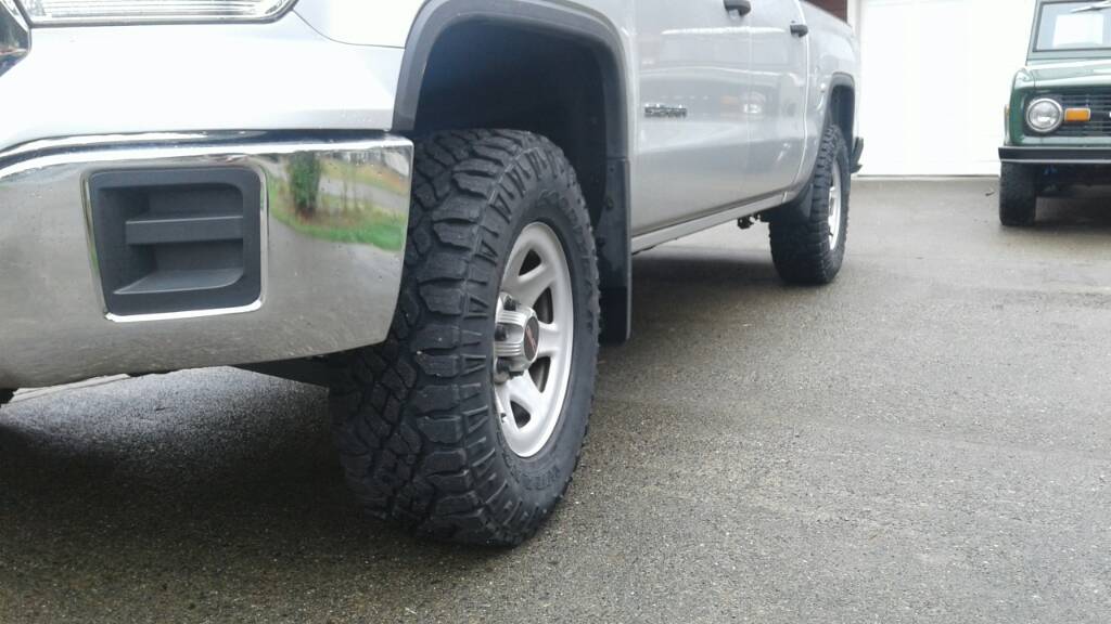

Here's mine, for the few that still like 17's. Just home from the tire shop. Pics don't do it justice at all.
2015 base
ProComp 2-1/4 front level (measures almost 2-1/2)
Duratrac 285/70 r17 on stockers
No tie wraps, no rub.

Wow no rub on stock wheels? No spacers or anything?

Nope. So far all is clear somehow. All I got is the 2.5" RC level/lift depending on who you ask. It's a level to me. No front wheel spacers. Was nervous to say the least. Fits like it should.

You might be the first person I've seen on here that fit that size without aftermarket wheels. Nice to know in case I wanted to keep the stockers.
