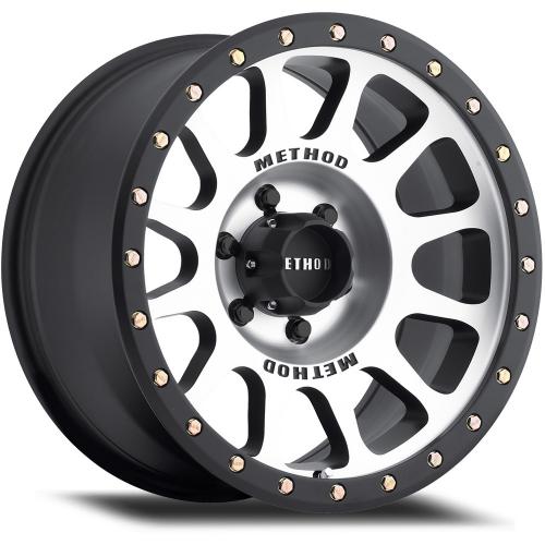

So for those wanting to know i emailed method about them offering their Titanium finish in other wheel sets and the answer was no :( only Grid...

I am looking to get these Method NV 18"x9" with 275/70R18 Falken Wildpeak AT3, I only have a RC 2" level, do you think -12 offset would rub or not. I think +0 would be ideal, but these wheels are only available in +18 or -12. Anything information would help. Thanks in advance. - Kenneth

You could go with 17s and a 285/70/17
Almost the same height and a tad wider
Thats what i'm looking into.

You will definitely rub the liner at full lock at the very least. Probably can get away with zip tie method to clear it. 285 65 18 on 18x9 -12 fuels rubs with 2-1/2" level but only the felt easily fixed with a zip tie.

Exactly what I run with RC 2" level. No rubbing.

Thanks for the info, the zip tie method would work with me. I got a great deal on those tires, just looking for wheels right now.
