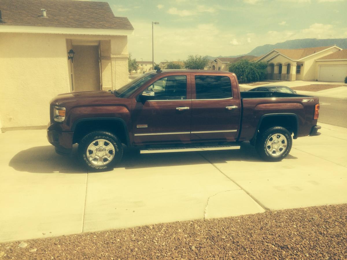

I have the rough country 2.5 level lift kit on stock tires for now. I will be getting bigger tires on the 18 inch oem rims. I like bigger tires smaller rims. Rides better handles better for actual off road use and has that classic 4x4 look. I had 305s on my 2004 with 17 inch rims and it was smooth riding and I loved off roading it when I could. My question really for those who have the 18 inch rims with biger tires. I saw a couple on here, and was wondering if the 305 60(65) R18 rub at all? I dont mind a little rub but better if it doesnt. I will be pricing tires for a while until I cant pass up new tires. I will post a pic up of my setup now with the leveling kit on stock tires. Then as soon as I get the new setup a new pic.
305/65 on stock rims may give enough clearance. With my -12 offset it rubbed and needed to be trimmed.
305/60 shouldn't need a trim.
Makes sense. I'm going stock rims so honestly without spacers and things of that nature it is what I want on my truck. No rub or little to no rub. You don't have a lift kit on yours do you?
