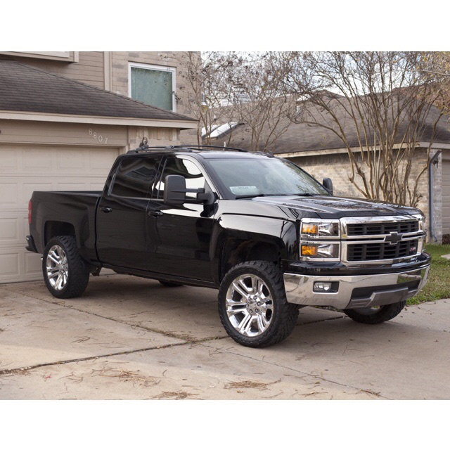

Here's a truck very close to what I want, 3.5" lift on 33"s. He's running 2" spacers though.

I really don't want to go that high. I looked at a truck with a 6" and I just thought it was a little too much. Maybe I could just stick with 33"s, but man, I bet 35"s would look tits.

I wouldn't bet on 35s fitting cleanly with that kit. That pic of the 3.5" with 33s looks stuffed. As far as the offset on the factory 22s. You may get away with it without spacers. You'll note that the bs allowance is greater with increased wheel diameter just due to spindle clearance. If not just roll with half inch spacers up front and 2" out back

Here's a truck with the 7 inch RCX on 20"s and 35"s. I'm really liking the look and I'm kinda torn on the 5 inch and 33"s or 7 inch and 35"s.
