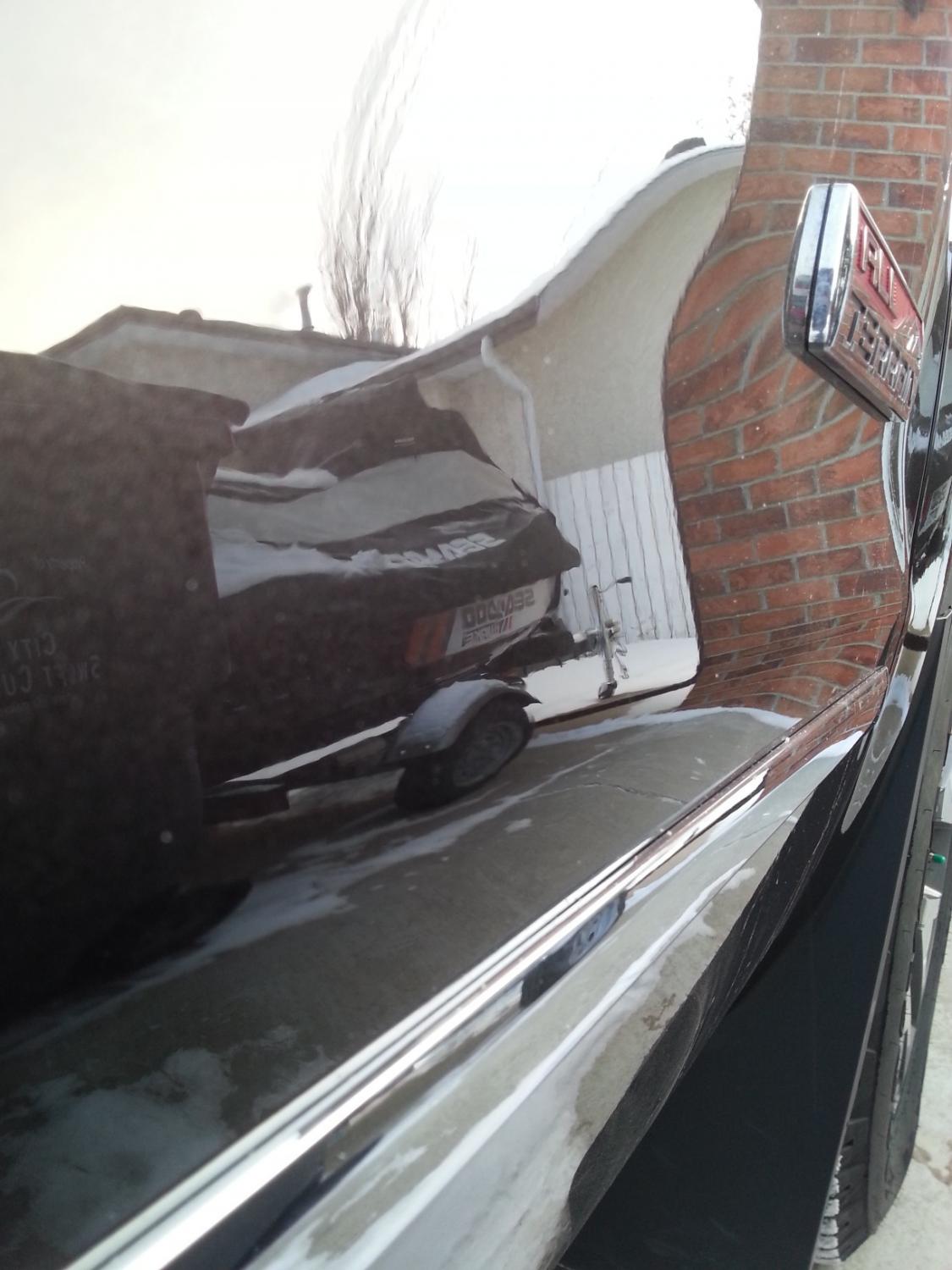

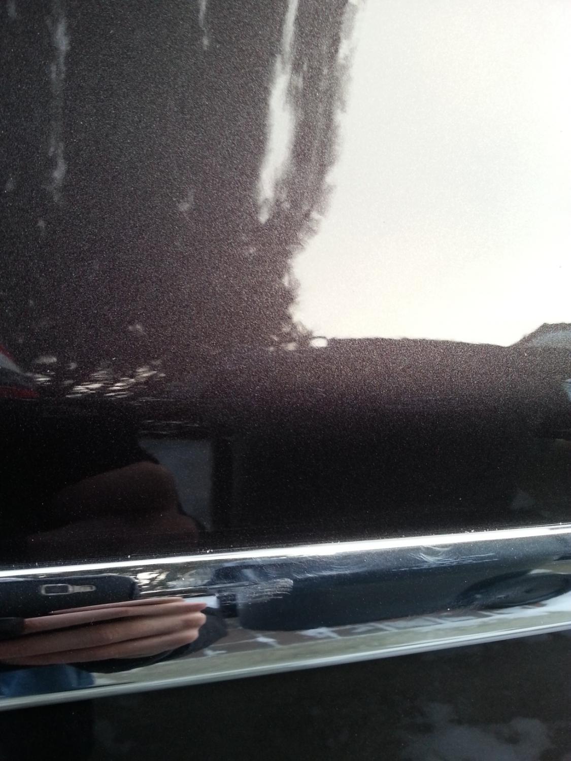

Is there any hope in fixing this?
There is no need to remove anything, most dent guys will either drill a hole in the door jam or use a glue pulling method.

My last work truck was a 04 suburban and the quarter panels are thought to access, that being said it just depends on the location of the dent. Like I mentioned earlier a good dent guy can glue pull it, it's a process of gluing a tab to the panel and using a slide hammer to pull the dent out, then removing the tab/glue and tap it down even. YouTube for glue pulling to get a idea of how it works.
Took my truck in this morning to the local PDR guy in town. He's been doing it for a couple years and I had heard some good things about him.
He had a look at my truck and said the dent is in the absolute worst possible place. He mentioned the same thing I did that the molding should be higher and said the Fords have the same problem. He's going to see what he can do with it but did tell me it's going to be hard to make it completely disappear. I'll post pics when I pick my truck up and see how he did.

Nope. had a dent in the same exact spot. problem with the dent doctor guys said I tried two of them, was theres metal supports right there, and the new steel over the last few years is a lot stiffer. I tried two guys with no luck. had to get painted and fixed cost 480 bucks. If you go that route take it in and dont mention insurance tell them you want to pay cash.
Some dents are not fixable 100% , however a good dent guy can do wonders. Like I said earlier you NEED a guy with years under his belt, Not to say anything bad about another dent guy and his skills but I fix thing now I would have never been able to fix with just a few years experiance. Also the bracing in the door can work for you or against you when doing dents , most of the time they give you something to pry against. Any new dent guy can fix standard door dings even with a few weeks experience , complexed dents on bodylines take a while to learn to do them right .Good Luck.

Your right. The guys I went both had over 10 years of experience and are highly reputable in the area. THey did buff out the scratching and move it out a little bit, but I would say it made it 25% all in all, and my dent is the same as the OPs. Unless some guy can do wonders and after watching two guys work at mine I doubt he'll get them to fix it.
Well here's the final result. The guy worked on it for 2 hours. He had to glue a tab on it, work it from the top from the window and also had to drill a hole to work it from the side. If you really look from some angles you can see a tiny flat spot where the dent was. It is 98% fixed and I am very happy!
Cost me $80, money well spent to me.
Very nice, I tell my customers when I can't fix them 100% that most people wouldn't be able to see the repair except me ,for looking at it for a hour and them for knowing exactly where it was. Most of the time only I see the imperfection but still tell the customer that one day in a certain light or angle they might see it.
