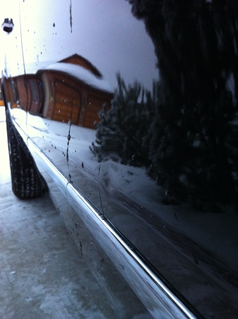

Is there any hope in fixing this?
I got the mother of all door dings the other day while christmas shopping.
The door hit mine and dented right on the crease of my door and up a couple inches from there. There are also scratch marks up my entire door and on my molding. Is there any hope in fixing this dent by paintless dent repair because it is on the worst part of the door?

It might be worth while taking it to some who does PDR (Paintless Dent Removal)....they may be able to get the dent out or at least minimize it drastically without the need for major body work, etc. My father had a similar size dent on his Silverado in the same general area and the PDR process was able to take care of it. You couldnt even tell it was hit and I usually have a good eye for those things.

I would take it to a PDR and at least ask. I think they can make it better, but might have to drill a small hole on the inside.
I've got a friend that has done auto damage appraisals for years. He says much to his amazement the PDR folks can get even the most ugly of hail dents out of vehicles that look like someone took a baseball bat to them. Although it is in the crease of the door, that one for a good PDR person should be a piece of cake.

Unfortunately I didn't even realize the dent until I washed the truck. I will be taking it to a PDR guy in town and see what they can do. Will post pics if he's able to fix it up.

I had a dent in the same area on my rear door. Because of where the ding is at it is unlikely it can be 100% removed. The guy was able to improve mine by about 80% and you can't tell it's there.
I've been doing pdr for 16 years now and I'd say it's fixable ,do your research and find a good for guy with a few years under his belt. A new guy in the business can screw it up in a hurry. Post some pictures of the repair, check out my site for a few before and after pictures, www.dentdave.com
Doesn't look too bad, I have no experience in PDR but looks easily accessible by removing the door panel. This is also why I decide to get extra exercise and park far away.
There is no need to remove anything, most dent guys will either drill a hole in the door jam or use a glue pulling method.
