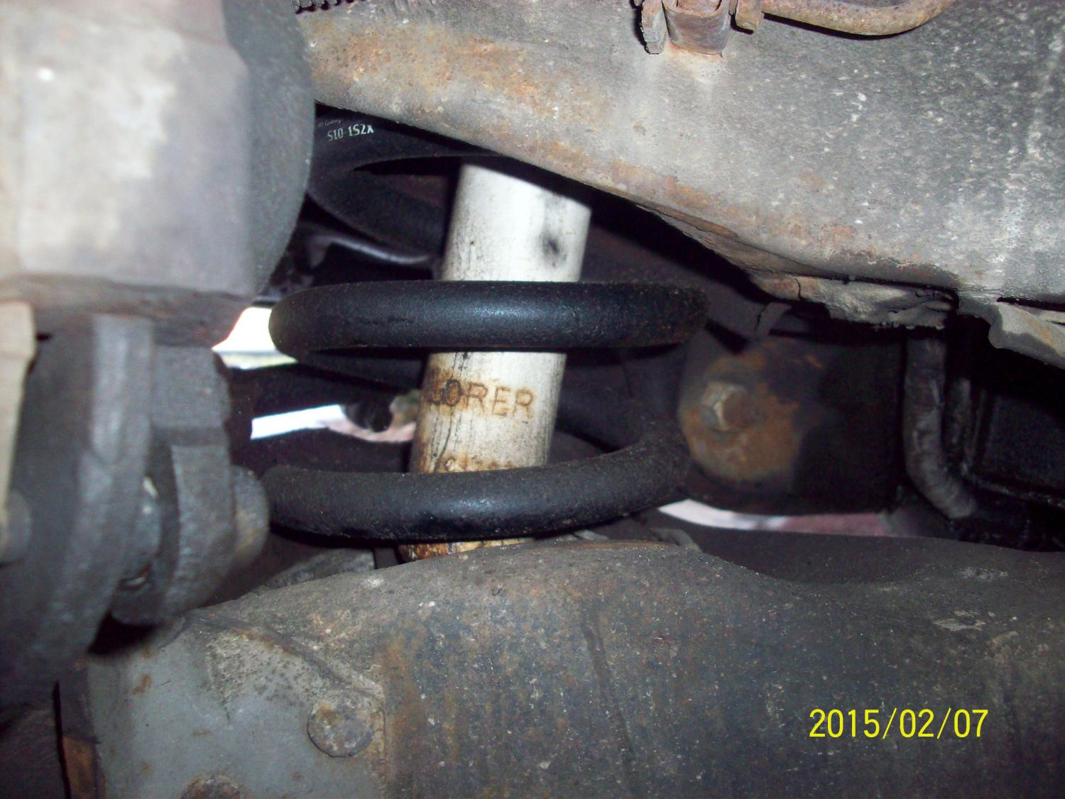

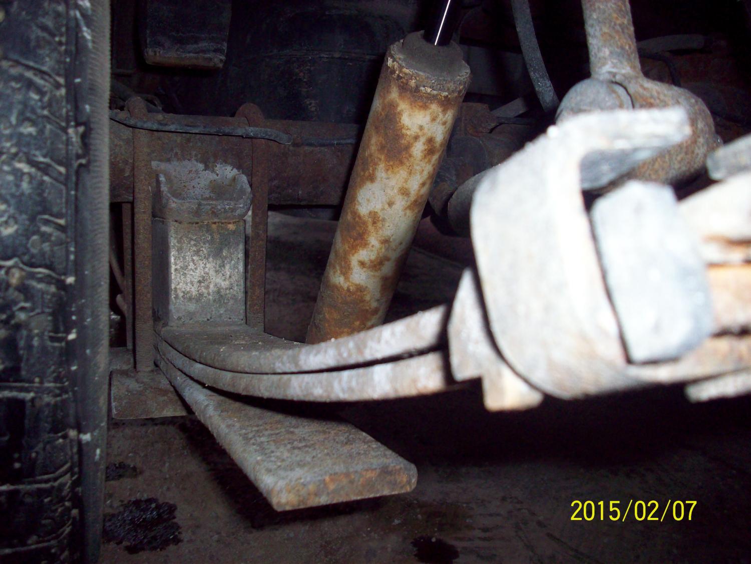

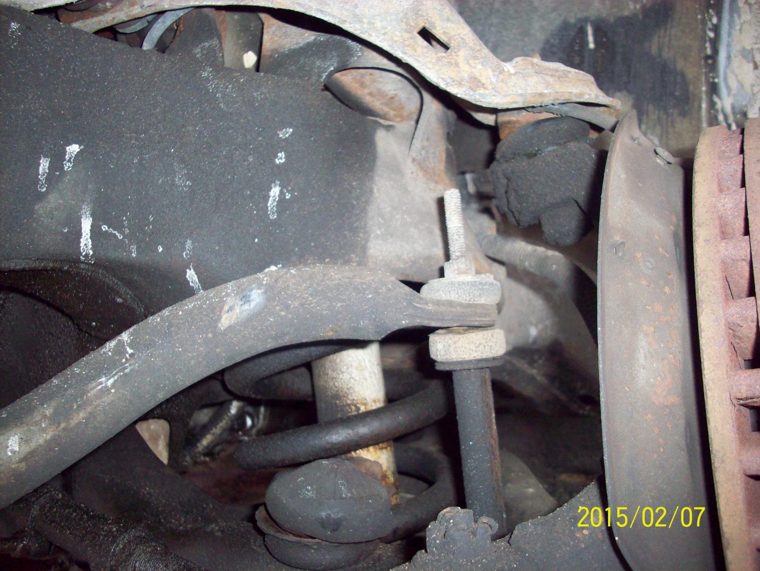

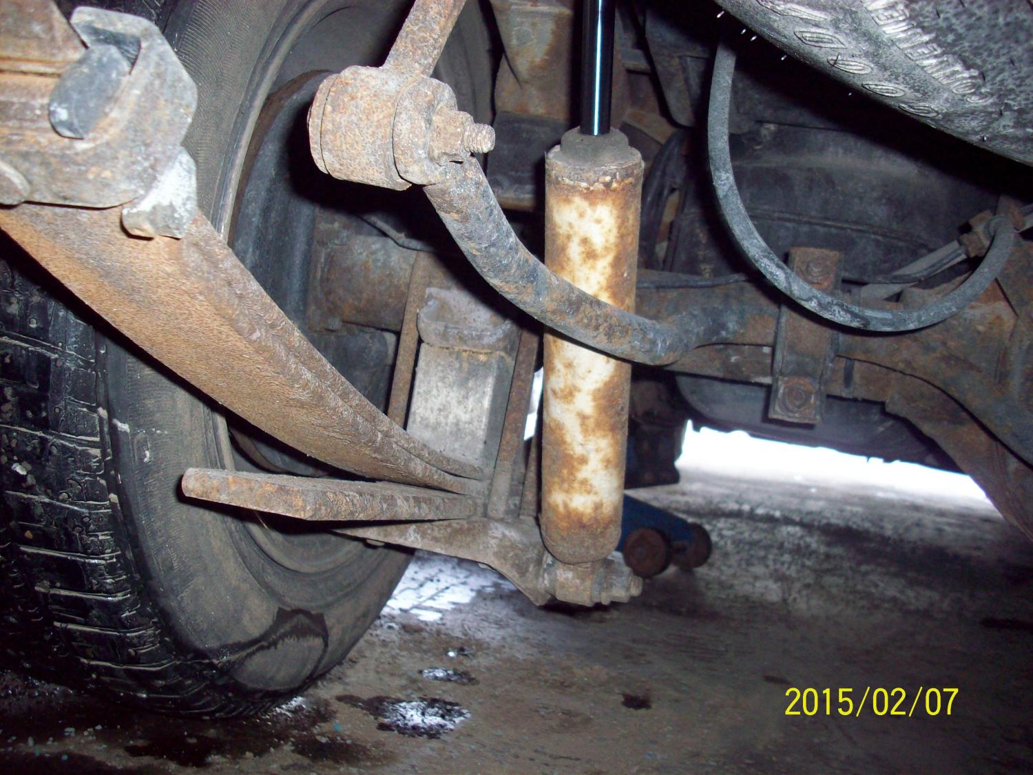

I tried to take some good ones. I hope these help. what do you guys think?
It looks like the coil isn't in the bucket, like it's been cut and just slapped together..
Ya from what I can tell you might just need to buy stock coil springs for the front and take out the axle blocks from between the axle and leaf springs. But like I said, I don't know much about lowering but that's what I can tell. I bet it rides like sh*t too with cut coils.

It's the blocks between the axle itself and the leaf spring. Think of it has a lift block on a lift kit but just under the axle to lower. All you'd have to buy for the rear is stock length u-bolts. So new coil springs for the front and take the rear axle blocks out and use stock length u-bolts. That is if I'm right about the front and rear.
Look at one of your pics, I circled the block with a black circle.
