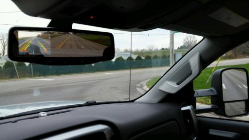

After not getting any response on here or by email from MVI and being kinda nervous about having to reprogram the truck I went the backup cam in the rearview mirror route. Which I am very happy with.
I've had my camera installed for about a month and a half now and no issues. Like I mentioned above very happy with it.
