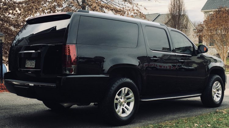

I went from the stock 265/65/18 Bridgestone duelers to 275/70/18 BFG A/T on a leveled set up...you can for sure feel the weight difference for this particular brand... not major but definitely not as quick of the light anymore.

My truck doesn't move at all doing 80 mph in torrential rains with BFG KO2s.  Excellent wet weather tread and they look great too.  Running stock size in a C-Ply to cut down on weight.  6 pounds heavier than stock each.  The truck felt like it had a converter and would not coast with E-Ply BFG Rugged Trails @ 50 lbs each.  It's now light and nimble and can pretty much go anywhere.
