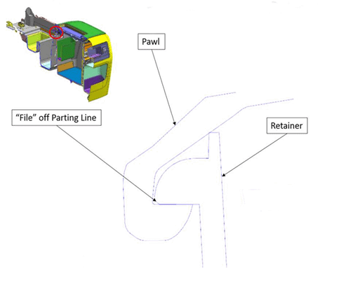

#PI1262: Noise Heard from Center Console - (Jun 18, 2014)
Subject: Noise Heard from Center Console 999999995.gif Models: 2014 Chevrolet Silverado 1500 2014 GMC Sierra 1500 Condition/Concern
Some customers may comment on a noise heard from the center console.
This condition may be caused by a plastic burr on the center console retainer.
Recommendation/Instructions
Modify the retainer using a file to remove the parting line as shown in the illustration above.

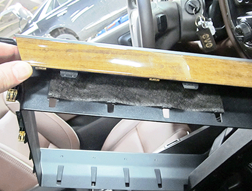

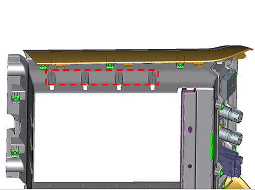

Condition/Concern
Some customers may comment on hearing a rattle noise coming from the front floor center console/cup holder area.
The cause of this condition may be build variation of the console components, which creates a loose interface between the console trim plate and the floor console assembly.
Add felt flocking tape to the front floor console trim plate following the steps and information below:
Note: The tape should line up to the bottom edge of the standings ribs, and should cover all four ribs.
  1. Remove the floor console cup holder and trim plate. Refer to Front Floor Console Trim Plate Replacement in SI.
  2. At the location shown in the illustration above, add an approximate 40 mm x 210 mm (1.58 in x 8.3 in) piece of Kent Automotive BRS flocking tape P/N KT13487, or equivalent, to both sides of the trim plate.
  3. Reinstall the floor console trim plate and cup holder. Refer to Front Floor Console Trim Plate Replacement in SI.
  4. Verify the rattle condition has been repaired.

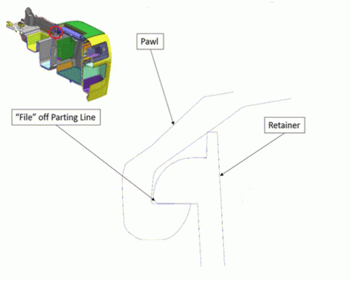

Subject:
Models:
Condition/Concern
