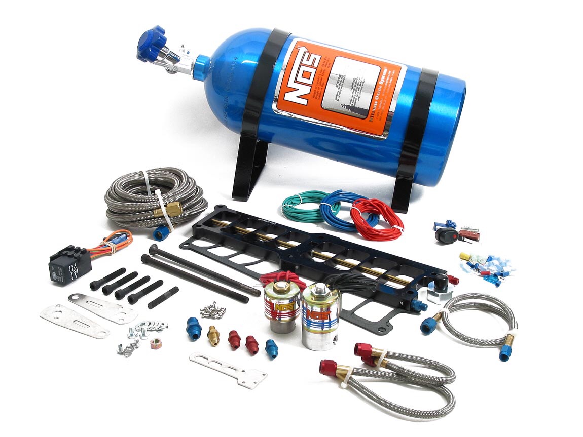

Yes you could use a nos setup into your pcv hose that you hook a catch can up to with seafoam or CRC. Give it a little shot every now and then. The only way to prevent this build up is to use products like CRC every 10,000 miles or even every oil change in conjunction with a catch can. They also say for people that perform short trips all the time it will build up worse.

NOS idea aside (I like that idea btw. :lol:) I am thinking it may be a good idea to install some sort of closeable valve in the air intake tube to make this easier to do on a regular basis. Just open it, stick the hose in and do your thing.
I mean not that pulling the tube of the air box was hard, but if I were to say get a CAI intake or something.. might be a little trickier. And it seems the closer you get to the TB the less of this stuff gets lost in the intake tube and goes into the TB.. Some kind of tiny open/close nozzle would do the trick.
All you would really need to do is drill a hole in the top of the air tube right before the throttle body and use a rubber grommet to seal it.

Not a bad idea, but I wasn't suggesting he inject CRC ;)
