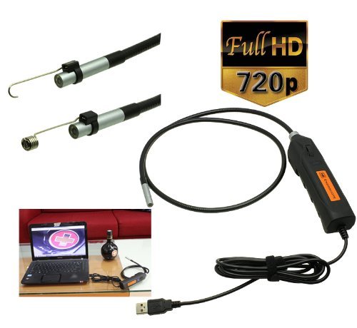

I know what you mean. The runners intersect the plenum at a right angle to the throttle body inlet also. It's a longshot, but I ordered a $35 borescope 1 meter long. I can always pull a plug and look at a valve that's open to see how bad my engine looks. More toys.
http://www.amazon.com/gp/product/B00G91N362/ref=oh_aui_detailpage_o00_s00?ie=UTF8&psc=1
