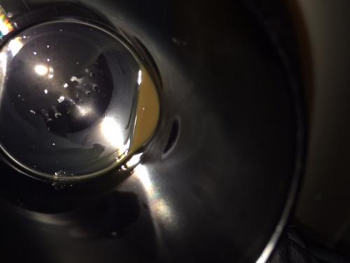

I thought about doing something like this too but I think it might be pretty difficult. On the inside of the intake manifold, the runners aren't easily accessible because of a cylinder that starts at the throttle body and goes about half way back. Here is a picture from PickUPS in the "Oil Catch can?" thread showing the inside of his intake manifold. This is on a 4.3 but the 5.3 is similar. I don't want to discourage you from trying to get a camera down to the intake valves but just wanted to let you know that it might be tricky. If you get it to work let me know as I would be interested in getting one of those cameras then.
IMG_2402behindthrottle-bodynovalleyventt
Got the scope in. Playing ...
Got the scope in. Playing ... IQ is meh. Depth of field could be better.
