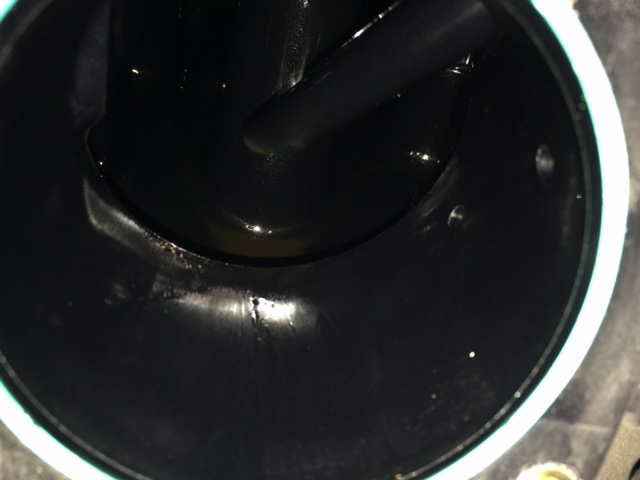

Hard to say for sure from just those pix. Did you see oil from the PCV tap, downstream, inside the manifold? I'm wondering if this could be a valve guide oiling issue with a little reversion spreading it upstream?
Yes there was oil covering the inside of the intake.

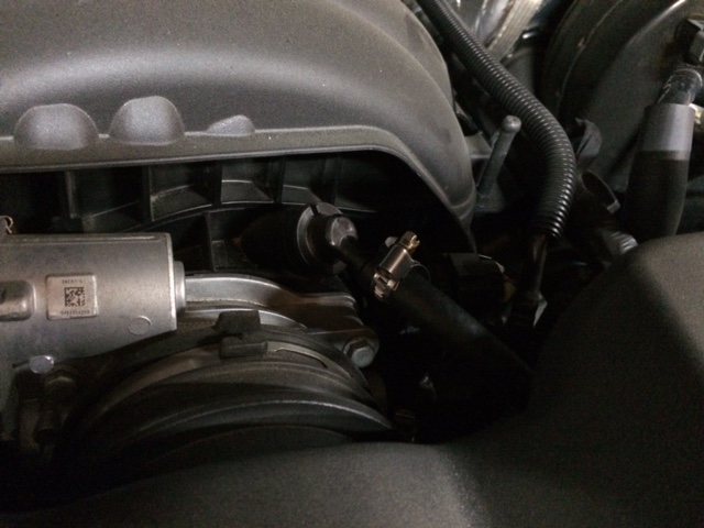

I thought about doing something like this too but I think it might be pretty difficult. On the inside of the intake manifold, the runners aren't easily accessible because of a cylinder that starts at the throttle body and goes about half way back. Here is a picture from PickUPS in the "Oil Catch can?" thread showing the inside of his intake manifold. This is on a 4.3 but the 5.3 is similar. I don't want to discourage you from trying to get a camera down to the intake valves but just wanted to let you know that it might be tricky. If you get it to work let me know as I would be interested in getting one of those cameras then.

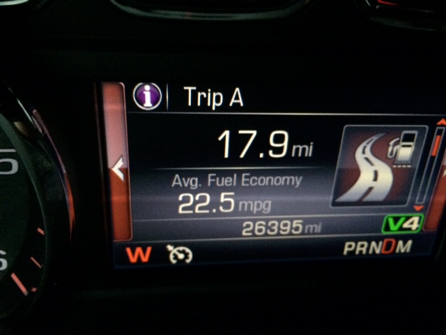

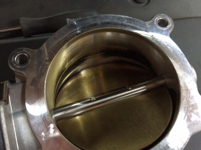

Still watching things. Here's evidence from this morning. Same commute, as always. Same EXACT procedure now and before the CRC, ie reset on interstate ramp, cruise set @ 70 and keep it there as traffic allows. This morning 5.3 miles was at 70, the rest was stop and go to never exceed 25mph again. Here are the #'s:

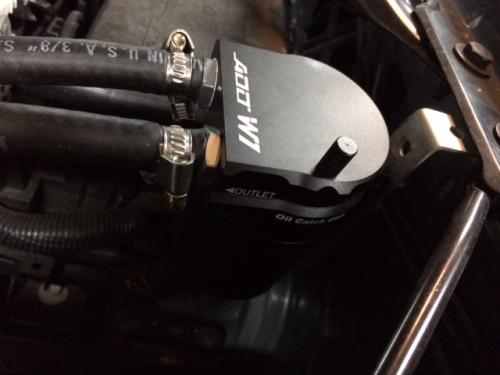

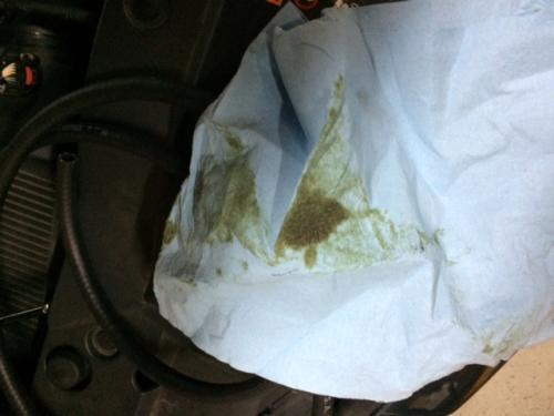

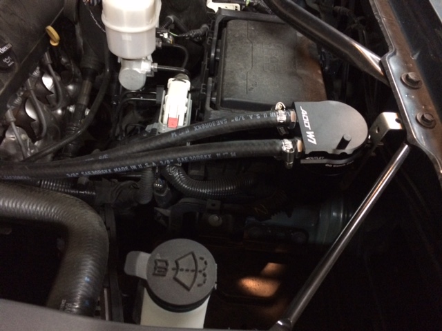

Also, installed my ADD W1 catch can last night. Was rather horrified at what I found. EVERYTHING covered in oil. I was in it up to my elbows by the time I got the TB off. Even the intake silencer had a fine film in it. TB was crudded up very nicely. Pools of oil/sludge in intake. Nastiness everywhere. Unbelievable. Someone had mentioned taking about LSx's before and no evidence of oil, I beg to differ. I've had MANY an LSx apart, and they ALLLL had intake oil to some degree w/ the LS1 style probably being the worst. I have a homemade catch can on my TA which I have to dump regularly. I thought it was bad, it's got nothing on the truck. Check out the pics. Install isn't done yet, still need to tidy up hoses, etc. My OCD didn't allow me to use white ty wraps. I'll report on the oil collection tonight. Didn't figure ~18 miles was enough to show a lot.
To those that disagree w/ the procedure and what it may OR MAY NOT do, well to each his own. All I wanted to do was share my experience and info. You go make your own decision and I certainly hope whatever you choose brings you the utmost happiness. For me, I'll have a can handy every 5/10k or so. Hopefully with the catch can I'll need it less often.

Since the treatment its been holding onto the 19s well though. It was in the high 17s before.

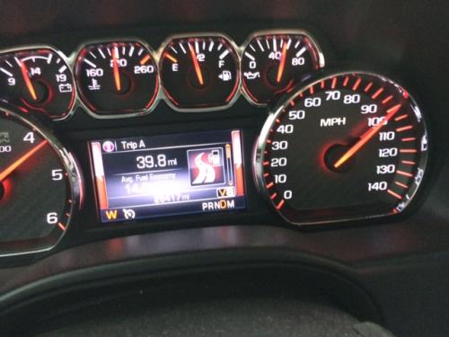

So this afternoon I had several errands to run. Combined with relentless afternoon traffic/construction issues, it was a fun backroad trip. Just to answer those who may believe I always get 24mpg...not the case. But I wanted to see how bad it could get!
I flogged the holy livin piss out of it. Like, bad. I treated the throttle like a two position switch. I saw WOT at every single (safe) opportunity, and >100 mph no less than 4 times (pic evidence below). I did see a moment where the mpg fell below 15, but the 53.7 mile average came in at a reasonably respectable 15.9. And I'm serious when I say I beat on it like a 14yr old boy who found his first JCPenny Spring Catalog.

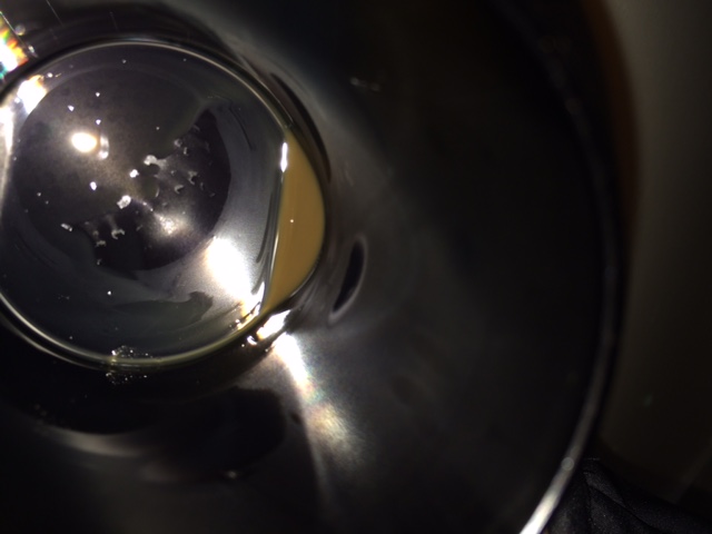

Anyway, evidence below plus the results of the first ~54 miles on the catch can. Maybe 1/4 oz, but still very disappointing. Not in the performance of the can - which I'm VERY happy with - but the fact that this is needed on such a vehicle.
OK.. I'm getting a catch can. There a thread for this? (I'm sure there is.. but.. I need to know how to install it.)

I did post one pic of the intake, which did (kinda, bad pic) show oil literally pooled in the intake. Obviously I couldn't reach all with the rag, but there was a depressing amount of oil in the valley.
