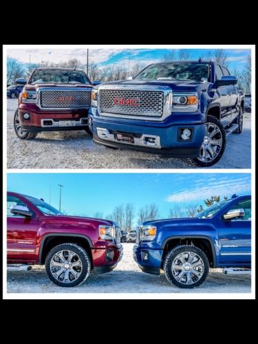

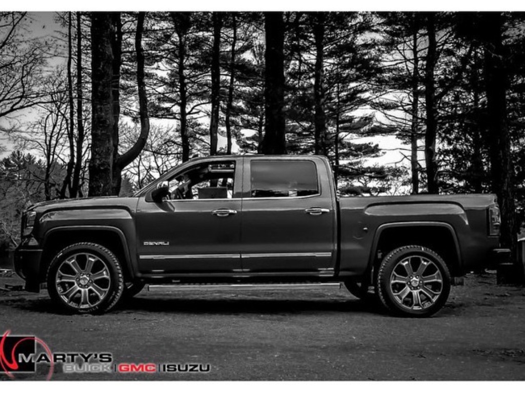

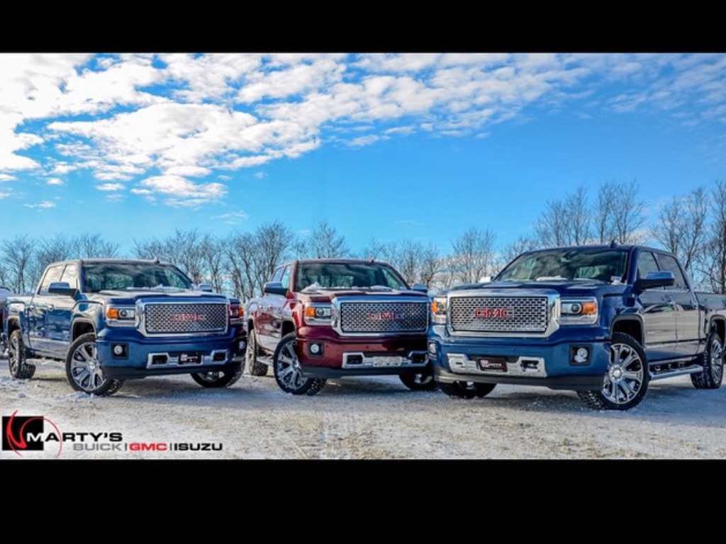

I just pulled the trigger on the OEM CK 164 22" wheels. They should be here Friday or Monday. If I dislike the ride over my 20" Michelins, you may want to hang tight for a smokin' deal on some 22" wheels and tires from me. ;)
These pics right here sold me on the CK 164
post-123573-0-92002300-1427200306_thumb.jpgpost-123573-0-03048000-1427200325_thumb.jpgpost-123573-0-50394700-1427200343_thumb.jpg
Photo cred to Brian Mello/Marty's Buick GMC

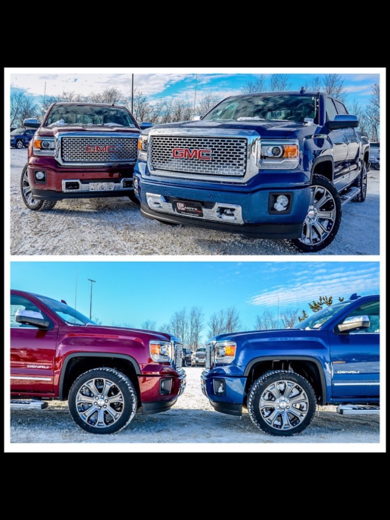

Damn ur making me wanna get those for my 2015 cc they look nice
Damn those are sweet wheels. No dealer involvement needed. It kind of annoys me that they tell you something like that. As mentioned, if the overall tire size is close to stock tire size, then nothing needs done.
